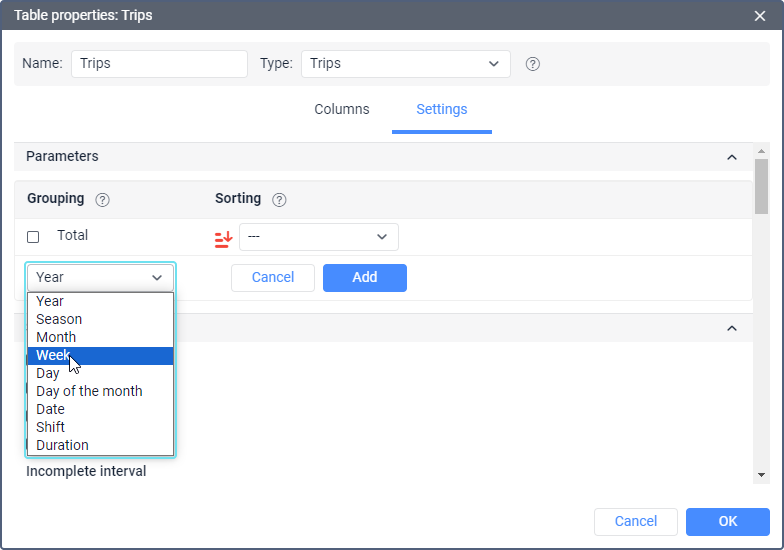

Grouping
Grouping is the arrangement of information based on the indicated characteristics.
When adding a new grouping, do the following:
  1. Click Add grouping.
  2. Select a time interval in the drop-down list.
  3. Click Add.
From the available time intervals (year, season, month, week, day of the month, day, date, shift, duration), select those based on which you want to group the tabular data. Grouping can be either single- or multi-level. Multi-level grouping implies that there are several groupings for different time intervals. When using it, it is required to assign a hierarchy (specify nesting). For example, the grouping can be as follows: tabular data is grouped by year, within each year by months, and within months by days. Nesting is adjusted by dragging the intervals in the Grouping column up or down, with the elements above in the list containing the ones that are located below.
When grouping by day is used, the intervals which cross the end of one day and the beginning of the next one are not split into several intervals in the report, but belong to the first day.
If grouping by such intervals as season and duration is selected, at the bottom you can find a special block where it is necessary to set values for the intervals.

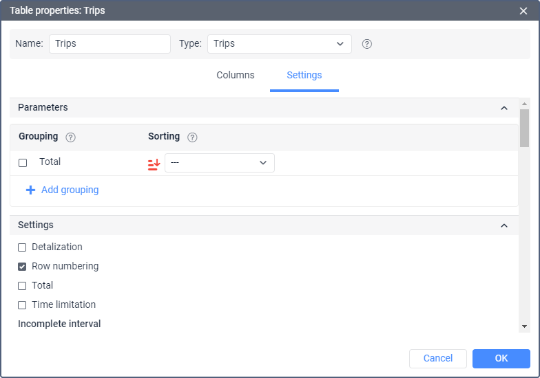

By default, there is no grouping, i.e. without adding grouping or sorting settings, we would get a detailed report where an individual line would correspond to each criterion. These lines would be arranged in chronological order or according to the sorting, indicated next to the Total grouping.
The report table with default settings is shown below.

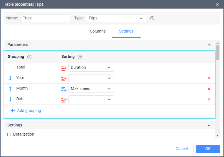

In order to get the result that corresponds to our task, we need to add the Year, Month and Date groupings. If necessary, we can move the grouping criteria to the desired position in the list (we need the Year –> Month –> Date sequence).
Next, we determine the sorting criteria and direction. Since we want to set sorting for the level nested in months (for dates), we select the corresponding criterion from the drop-down list of months. Then click the icon of sorting direction to adjust it from a bigger to a smaller value.
By default, the data is sorted in chronological order.

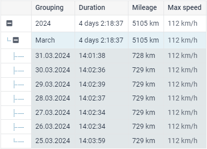

The report looks as follows:
Compared to the table for which the grouping and sorting settings are not specified, this table has two additional columns. The first one is a column containing the + and - buttons, which help show/hide nesting levels. The second is the Grouping column, which shows the levels themselves. The information in the table is grouped by years, and by clicking on the plus the next levels of grouping (months, dates) are opened. The dates are sorted by the maximum speed (from high to low).

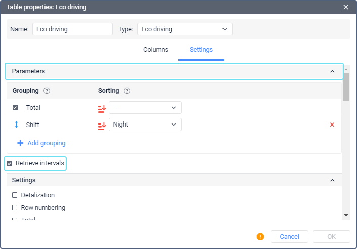

Retrieve intervals
The Retrieve intervals option in Parameters section is applied only to reports with grouping by shifts. If the option is activated, the report displays only those parts of trips which have overlapped the shifts on the specified interval. If the option is deactivated, the report shows all the trips which have overlapped the shifts at least partially on the specified interval, and these trips are included in the report from beginning to end.
The Retrieve intervals options are also available in the Interval filtering section for some filters.
