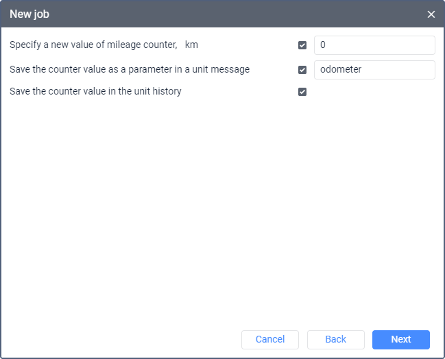

Save and/or change the value of the mileage counter
In the settings of this job, you can select one or more actions related to changing and saving the mileage counter values.
The following options are available:
| Option | Description |
| Specify a new value of mileage counter | Allows resetting the mileage counter to zero or specifying any value for it. For this purpose, enable the option and enter the value (in km) which should be applied after the job is carried out. |
| Save the counter value as a parameter in a unit message | Allows saving the mileage counter value as a parameter in a message. Further on, you can create a mileage sensor based on this parameter and use this sensor to get the counter values in reports (the Initial mileage and Final mileage columns). You can also see the saved values by requesting data messages from the unit. The mileage value is shown in meters or feet, depending on the measurement systems of the unit. To use the option, enable it and enter the parameter name in the field. You can use only latin letters, special characters are not allowed. If the parameter name consists of several words, use an underscore instead of a space (for example, can_distance). It is advisable to save the counter values while the vehicle is parked, for example, once a day at night. |
| Save the counter value in the unit history | If the option is enabled, the mileage counter value is saved in the unit history. As a result, an event is registered in the system and you can see it in the Events or Chronology tables in reports. |

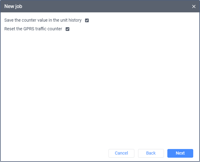

Save and/or reset the value of the GPRS traffic counter
The jobs of this type are usually used to:
- automatically reset the counter of consumed traffic on a regular basis (for example, once a month);
- save the values of consumed traffic in the unit history and run reports on it.
You can select the following options in the job settings:
| Save the counter value in the unit history | Allows saving the counter value in the unit history. As a result, an event is registered in the system and you can see it in the Events or Chronology tables in reports. If the Reset the GPRS traffic counter option is also enabled, the counter reset is saved as an event and is shown in the GPRS traffic table in reports. |
| Reset the GPRS traffic counter | Allows resetting the counter value to zero. |
