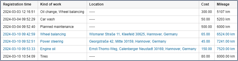

Maintenance
The Maintenance table contains the list of the service works performed during the indicated period and registered by the user for the selected unit.
The table can include the columns described below.
ColumnDescription
Service timeThe date and time indicated at the time of registration.
Registration timeThe date and time when the event was registered.
Kind of workThe information taken from the Kind of work field.
CommentThe information taken from the Description field.
LocationThe location indicated at registration.
DurationThe duration of technical work.
CostThe cost of service.
MileageThe value of the mileage counter at the time of maintenance.
Engine hoursThe value of the engine hours counter at the time of maintenance.
CountThe number of services.
