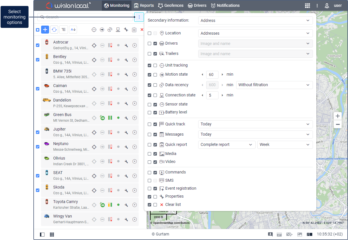

All the options that can be found on the Monitoring tab are described below. Depending on the tasks assigned, you can choose to display some columns and hide the others. To do this, the Can change settings option must be activated in the user properties.
By default, the Monitoring tab includes the following options:
  • address (in secondary information)
  • tracking units on map
  • motion state
  • data recency
  • connection state
  • quick track
  • properties
  • clear list
To customize the list, press the icon  in the upper right corner of the Monitoring tab. In the left column, select the options that should be displayed in the work list and in the monitoring options menu. In the right column, you can select the options that are used more rarely — they will be shown in the additional menu and will be available there.
