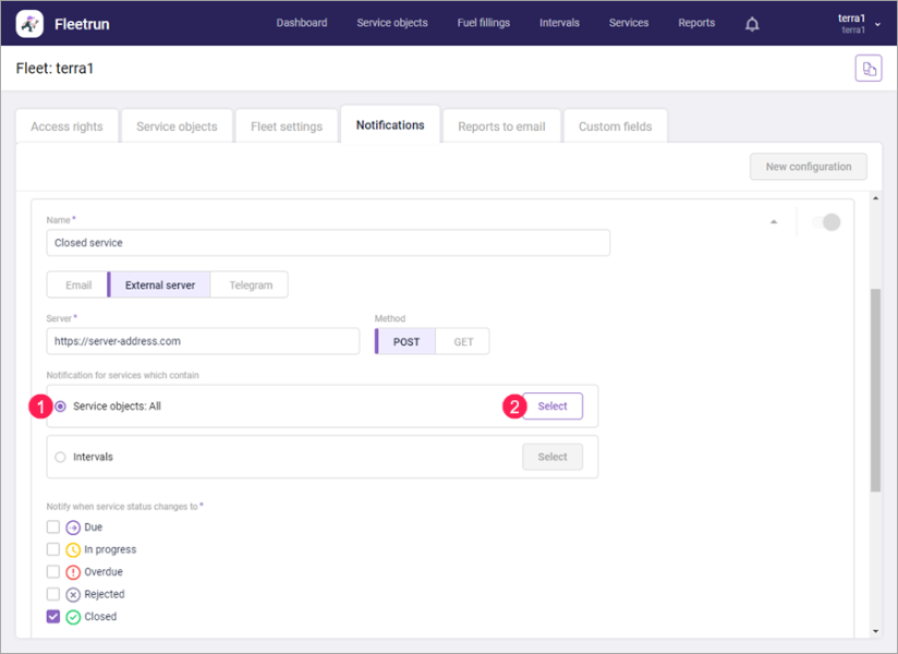

Notification for services which contain
The selection of service objects or intervals. Use this setting in order to receive notifications only about those services that are created for specific service objects or on the basis of specific intervals. You can select either service objects or intervals. By default, all service objects are selected.
You can only select the service objects added to the fleet, or those for which you are indicated as the creator. To select intervals, the user should have the rights to view and manage them.
To configure a notification for specific items, follow the steps below.
- Activate the required option (Service objects are activated by default).
- Click Select. The dialog box that opens next contains two lists: the right one displays the items available for selection, and the left one shows the already selected ones. All items are selected by default, therefore, the list on the right is empty.
- In the list of selected items, mark those about which you don’t want to receive notifications. For a quick search, use the filters by service object type and by unit type in the upper part of the dialog box. To mark all items, click Select all. You can clear the selection manually or by clicking Cancel (cancels the selection of all items).
- Click on the right arrow button to move the marked items to the list of the available ones. In this way, only the items about which you want to receive notifications are left in the list of the selected ones.
- Click Continue.
After that, you can see the number of the selected items next to the option name. If one item is selected, you can see its name instead.

Select the External server notification type and specify the properties listed below. The required ones are marked with an asterisk (*).
| Property | Description |
| Server* | The server to which the notification should be sent. The maximum length is 256 symbols. |
| Method | The method of sending the notification. The available options are POST and GET. POST is selected by default. |

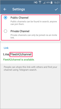

Create a channel
Tap the Pencil icon.
Select New Channel.
Specify the name of the channel.
Select the type of the channel. For a public channel, specify the name of the link. For a private channel, the link is generated automatically.
