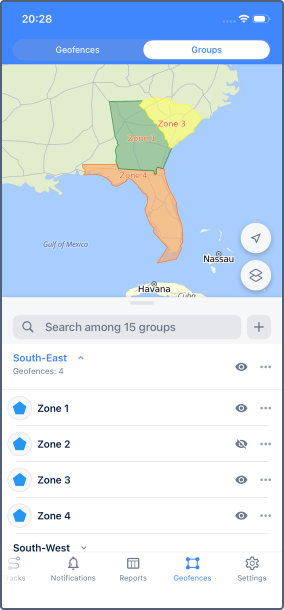

Geofence groups
In the Groups mode, you can see the names of groups and the number of geofences belonging to them. Tap the row with the name of the group to see the list of geofences.
In this mode, you can create geofence groups and perform the following actions with them: editing, deleting, creating notifications about crossing the borders of geofences belonging to groups. You can also show and hide geofence groups on the map.

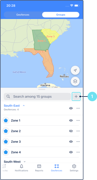

Creating groups
To create a geofence group, follow these steps:
  1. In the Groups mode, tap the icon   to the right of the search bar.

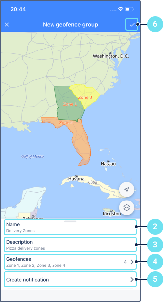

  2. Type in the name of the group and tap Save.
  3. If necessary, specify the description of the group.
  4. Select the geofences that should belong to the group.
  5. If necessary, tap Create notification to set up a notification for this geofence. See Creating notifications for geofences.
  6. Save the changes.

Showing and hiding geofence groups
To show or hide all geofences in a group on the map, tap the icon eye icon next to the group name in the list. You can show or hide individual geofences in a group the same way as in the Geofences mode. See Showing and hiding geofences.
