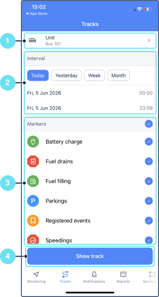

To generate a track, follow the steps below.
  1. On the Tracks tab, select the unit the track of which you want to generate.
  2. Specify the time interval for which you want to generate the track. There are two ways to do it:
    • Use quick buttons to select a preset interval: Today, Yesterday, Week, Month.
    • Tap the fields of the interval beginning and end to select custom date and time in the calendar.
  3. Select the event markers you want to see on the track.
  4. Tap Show track.
As a result, you will see a screen showing the track on the map, as well as an information section and the track player. See the description of this screen in the Customizing the “Tracks” tab appearance section.

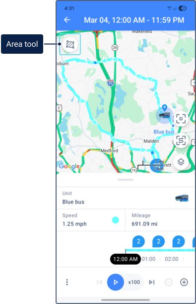

Using the “Area” tool
The Area tool helps you measure the area and perimeter of specific zones on the map. For example, it can be useful for measuring agricultural fields.
This tool works only online. Measurement results can’t be saved or downloaded. Make sure to record any measurements you need before closing the tool.
To open the tool, go to the Tracks tab, generate a track and tap the icon striped square with circular corners in the upper-left corner.

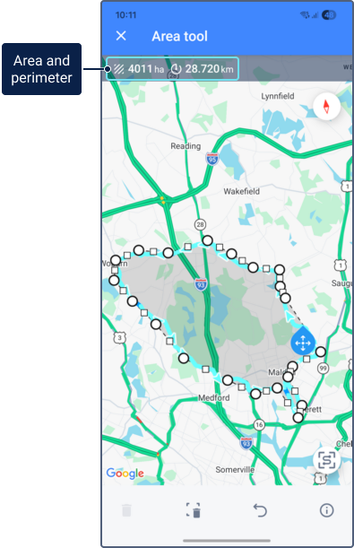

Once the tool is active, use the following actions to draw and edit your shape:
  • Add a point: Tap anywhere on the map to place the first point. Continue tapping to add more points and build a shape.
  • Move a point: Tap a point, then long-tap the icon blue teardrop with four-way arrows and drag it to adjust the point location.
  • View measurements: The calculated area and perimeter are displayed at the top of the screen. The values are updated in real time as you adjust the shape. The measurement system depends on the user settings from the web version.
The toolbar at the bottom of the screen provides additional actions:
  • Delete a point trash can: Tap a point to select it, then press the button trash can to remove it.
  • Start over trash can inside a dashed frame: Clears the map and deletes the entire shape so you can begin a new measurement.
  • Undo curved arrow pointing left: Reverts your last action while keeping all other changes.
  • Instructions letter "i" inside a circle : Displays in-app help on using the tool.
