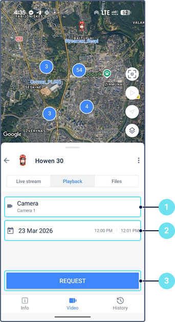

Requesting a playback
To request a playback, follow the steps below.
- In the Camera line, select one of the configured cameras from which you want to receive the playback.
- Specify the interval for which you want to request the playback. To do this, tap the date, select the required day, and tap Done. Then tap start and end time, set the required values, and tap Done. When specifying the interval, consider the following:
- The duration of the interval cannot go beyond 24 hours.
- You can specify the current or a past date. By default, the 24-hour interval of the previous date is selected.
- The end time should not be earlier than the start time.
- If the current date is specified, and the end time hasn’t come yet, the playback is requested up to now.
- Tap Request.
