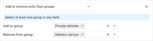

Add or remove units from groups
This action allows you to add or remove the selected unit from certain groups. To configure this action, select the required groups from the Add to group and/or Remove from group drop-down lists. You must select at least one group in any field.

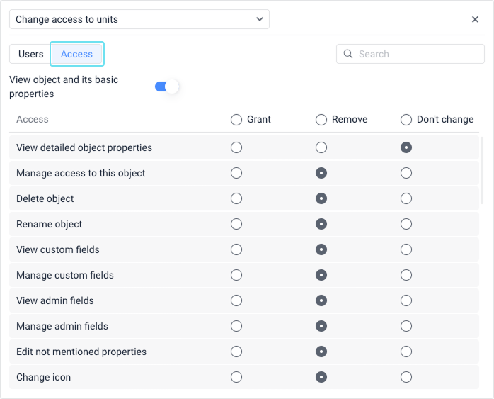

Change access to units
This action allows you to automatically change the user’s access rights to units. To do this, you should have the Manage access to this object access right to the user.
To configure this action, follow these steps:
  1. On the Users tab, select the users whose access rights you want to change. You can use the search bar to find them quickly.
  2. Switch to the Access tab.
  3. If you want to grant any access to the units, the basic View object and its basic properties toggle must be active. Conversely, if you want to remove all access, disable this toggle.
    If the View object and its basic properties toggle is disabled, the selected users will lose all access to the units.
  4. If the basic access right is enabled, you can configure the remaining access rights in the list below by selecting one of the radio buttons next to each:
  • Grant: Allows you to grant the users this access right.
  • Remove: Allows you to remove this access right from the users.
  • Don’t change: Allows you not to change the current state of this access right.
This action can be useful when granting users temporary access rights.

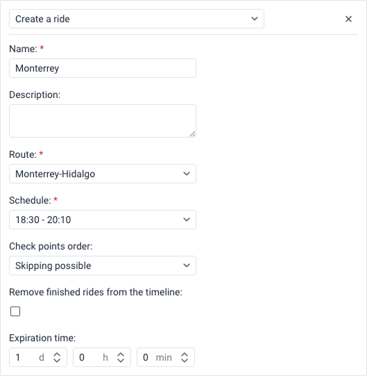

Create a ride
This action allows you to create a new ride for the unit. For example, when leaving a certain geofence or finishing a certain ride, the unit can start a new ride automatically.
  1. Specify the ride name (required).
  2. If necessary, add a description.
  3. Select the route from the drop-down list (required).
  4. Select the schedule of the route (required).
  5. Select the order of check points: Strict, Skipping possible, or Arbitrary.
  6. If necessary, check the Remove finished rides from the timeline option so that the timeline shows only those rides which are currently executing.
  7. In the Expiration time fields, specify the time (in days d, hours h, and minutes min) during which the ride can start.

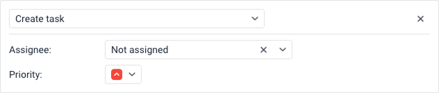

Create task
The Create task action is available if you have the Tasks service enabled in the properties of your account or billing plan. Also, you must have the access rights to units and users listed in the Prerequisites section of the Tasks page.
When a notification with this action is triggered, a task is created for the unit and is displayed on the Tasks tab.
To configure this action, follow the steps below:
  1. Select the user in the Assignee field, or leave the Not assigned option if the task should not be assigned to a specific user. You can clear the selection using the icon .
  2. Select the Priority that should be given to the created task from the drop-down list: Low, Medium, or High.
The created task has the New status, and its name and type match the name and type of the triggered notification. The notification text is displayed in the Description column.

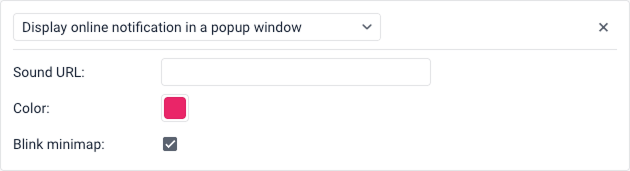

Display online notification in a popup window
This notification action allows you to display notifications in a pop-up window in Wialon (see more).
Sound URL
If the Play sound for events option is enabled in the user settings, the notifications are accompanied by an audio signal. In the Sound URL field, you can specify a direct link to the sound file, which must end with .mp3, .wav or .ogg depending on the file format. The recommended file size is up to 0.5 MB. If the field is not filled in, the default audio signal is used.
When using different browsers, take the following restrictions into account:
Browser Supported format
Internet Explorer 9+ MP3, AAC
Google Chrome 11+ MP3, WAV, Ogg
Mozilla Firefox 12+ WAV, Ogg
Safari 5+ MP3, WAV, AAC
Opera 10+ WAV, Ogg
Color
If necessary, you can select the notification indicator and background color. The default color is white.
If the Blink minimap option is enabled, once the notification is triggered, a mini-window opens in which you can track the movement of the unit.

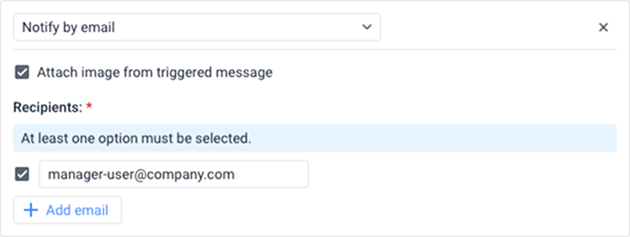

Notify by email
Prerequisites
To receive notifications by email, on the General tab of the billing plan properties, specify an email address from which system messages should be sent.
This action allows you to configure sending email notifications.
Some types of devices allow you to attach an image to the email sent by the unit in the message after which the notification was triggered. To do this, enable the Attach image from triggered message option.
In the Emails section, you must specify the addresses to which notifications should be sent. To do this:
  1. Click the Add email button to add a new input field.
  2. Check the box to the left of the field and enter the required email address.
  3. To cancel sending notifications to any of the specified addresses, simply uncheck the box to the left of that address.
At least one email option must be selected to save the action.

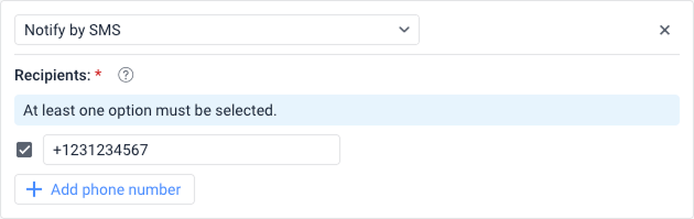

Notify by SMS
This action allows you to configure sending notifications as SMS messages. To do this, follow the next steps:
  1. Make sure that the Can send SMS option is enabled in the user properties.
  2. Make sure that SMS messages service is enabled in the account properties of the user who created the notification.
  3. In the Recipients section, specify the phone number in the international format (for example, +37060123456) and ensure the checkbox next to it is selected. To enter multiple numbers, click the Add phone number button.

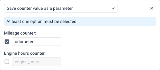

Save counter value as a parameter
Prerequisites
To use the Save counter value as a parameter action, you must have the Edit counters access right to the unit.
This action allows you to save the value of current mileage or engine hours as a parameter in the message. This is required in order to show the initial and final mileage values in the report on trips and convert the engine_hours parameter into the engine hours sensor for further operations.
To configure this action, check the box next to the counter you want to save: Mileage counter and/or Engine hours counter. You must select at least one option to save the action. The default parameter names are odometer and engine_hours, but you can customize these names in the provided text fields.

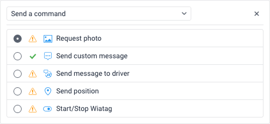

Send a command
This action allows you to send a certain command to the unit(s). The list contains all the available commands created in the properties of all the selected units if you have the Send commands access right to them. Select the command you want to execute using the radio buttons.
Next to the name of each command, you can see the following icons:
  • : means that all the selected units support this command;
  • : means that not all the selected units support this command (more information in the tooltip).
In the case of sending commands that involve entering text or a message (for example, Send custom message or Send message to driver), additional settings become available:
  • Message: Enter the required text. To save the message for future use, click the icon floppy disk icon. You can use the same tags as for the notification text. When executing the command, the specified tags are converted to the values that correspond to them.
  • Group: You can organize saved messages into categories. Select an existing group from the drop-down list, or click Add group to create a new one. You can also remove a selected group using the icon red cross icon.
  • Saved messages: Displays messages that have been saved previously. You can click a message to use it, or delete it from the list using the icon red cross icon.

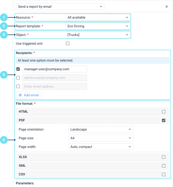

Send a report by email
This action allows you to send a report to one or several specified email addresses. To do this, you should have the Request messages and reports access right.
  1. Select the resource to which the report template belongs. To see templates from all the available resources, select the All available option.
  2. Select the report template you want to use.
  3. Select the object on which you want to execute the report.
  4. If necessary, check the Use triggered unit box. It is only available for reports on unit or unit group. If the option is enabled, the report is executed only on the unit that triggered the notification, regardless of the object selected in the previous list.
  5. In the Recipients section, specify the email addresses. Click the Add email button to add new input fields, and ensure the box next to the required address is checked. At least one option must be selected to save the action.
  6. Select one or several options in the File format section: HTML, PDF, XLSX, XML, or CSV. When selecting the PDF format, you can specify the page orientation, size, and width. When selecting the CSV format, you can specify the coding and delimiter as well as enable or disable the displaying of headings.

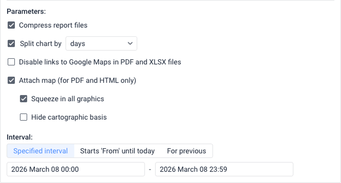

  7. In the Parameters section, configure additional report settings:
    • Compress report files
    • Split chart by
    • Disable links to Google Maps in PDF and XLSX files
    • Attach map (for PDF and HTML only), which includes sub-options to Squeeze in all graphics
    • Hide cartographic basis
      See the description of these options in the Export parameters section.
  8. Specify the time Interval for which the report should be executed by selecting one of the three tabs:
    • Specified interval: Enter the exact start and end dates and times (for example, 01 March 2026 00:00 - 01 March 2026 23:59).
    • Starts ‘From’ until today: This option allows you to set a specific starting date and time in the first field. The end time is automatically determined by the system (representing the moment the notification is triggered) and is shown in an inactive, grayed-out field.
    • For previous: This option allows you to define a relative time period. You specify a numerical value and select a time unit (such as “days”) from a drop-down list. Additionally, there is an Including current checkbox that you can enable to include the current, ongoing time period in the report interval.

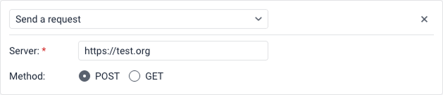

Send a request
This action allows you to send messages about triggered notifications to third-party servers. To configure this, follow the steps below:
  1. In the Server field, specify the URL, that is, the static part of the request.
  2. Select a method for the HTTP request using the radio buttons: POST or GET.
  3. Click Next.
  4. In the notification text field, specify the dynamic part of the request using tags. For example: param1=value1&param2=value2&param3=%UNIT%&param4=%SPEED%
When sending a GET request, its dynamic part is automatically added to the server address specified in step 1. When sending a POST request, the dynamic part is passed in the body of the request.

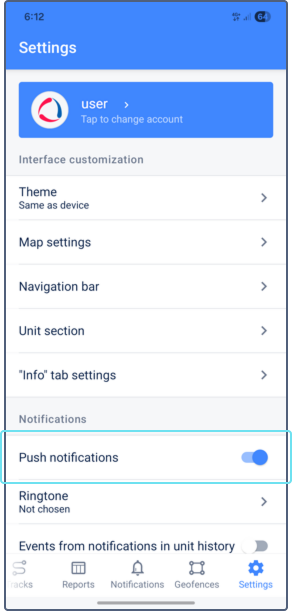

Send mobile notification
This action allows you to configure sending mobile notifications. The action is available if the Mobile notifications service is enabled in the properties of the user’s account.
Prerequisites
To work with this action, you should have the following access rights:
Access right type Access rights Description
Unit access rights View object and its basic properties The recipient users should have this access right to all the selected units.
Unit access rights Use unit in jobs, notifications, routes, retranslators The user who configures the notification and the user-creator of the resource to which the notification belongs should have this access right to all the selected units.
User access rights View detailed object properties The user who configures the notification should have these access rights to the recipient users and to the user-creator of the resource in which the notification is stored. The user-creator of the resource in which the notification is stored should have these access rights to the recipient users.
User access rights Act on behalf of this user The user who configures the notification should have these access rights to the recipient users and to the user-creator of the resource in which the notification is stored. The user-creator of the resource in which the notification is stored should have these access rights to the recipient users.
To configure sending mobile notifications, follow these steps:
  1. Make sure that the users who should receive notifications are authorized in the mobile application and have the option allowing them to receive notifications enabled. In the case of the Wialon mobile app, the Push notifications option should be enabled in the settings.
  2. Select the mobile application to which the notification should be sent from the Applications drop-down list.
  3. Optionally, select a notification color. This color is displayed on the left edge of notification cards in the mobile application. By default, no color is selected.
  4. Select the users who should receive the notification by checking the boxes next to their names. You can use the search bar above the list to find them quickly. To select all the users at once, check the box next to the Users title.

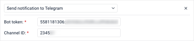

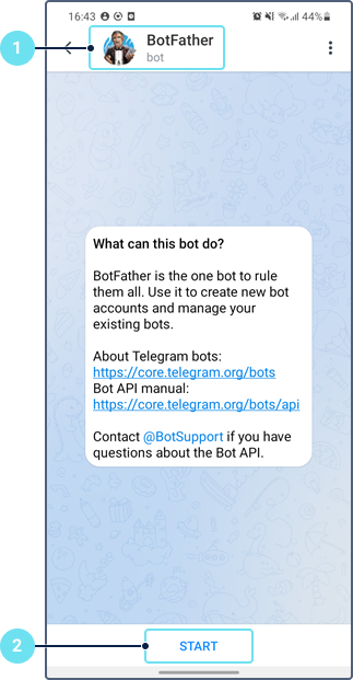

  1. Using the search, find and open the bot named BotFather.
  2. Tap Start.
  3. Select the /newbot command.
  4. Specify the bot name.
  5. Specify the user name for the bot. It should end with the word bot.
  6. Save the received token.
  7. Specify the token in the Bot token field.
  8. Select the /mybots command.
  9. Select the created bot.
  10. Tap Start.

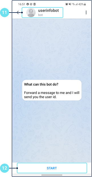

  11. Using the search, find and open the bot named userinfobot.
  12. Tap Start. After that, the user ID is sent. To find out the ID of another user, send any message to this bot on behalf of the required user.
  13. Specify the received ID in the Channel ID field.

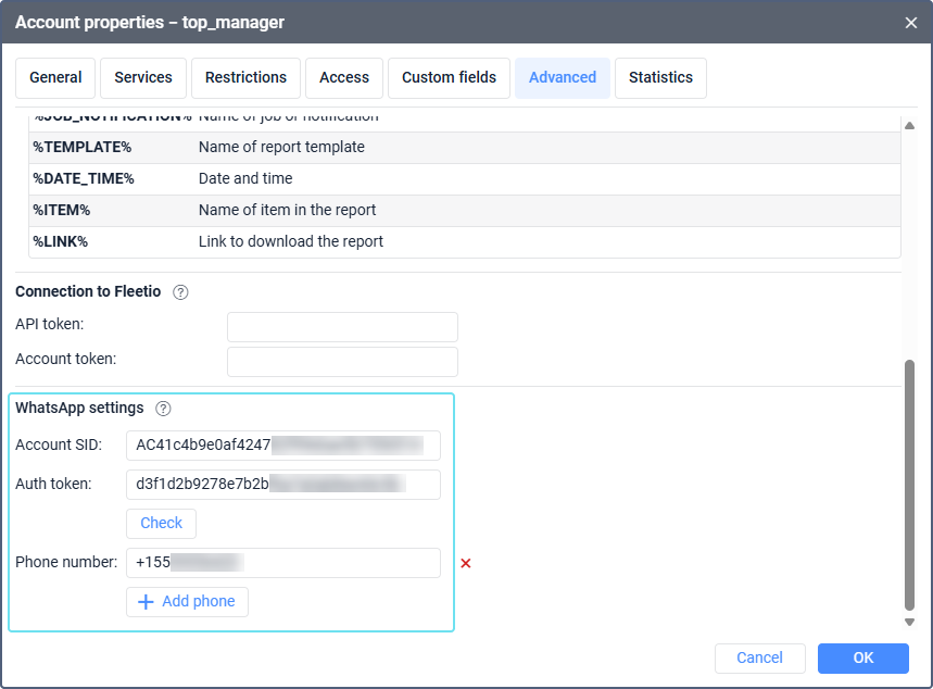

  3. In the WhatsApp settings section, enter the following credentials:
    • Account SID — the Twilio account SID.
    • Auth token — the Twilio Auth token.
  4. Click Check to verify the credentials. If the credentials are valid, the phone number fields become available.
  5. Add one or more sender phone numbers in international format (for example, +155XXXXXXXX).
  6. Click OK.

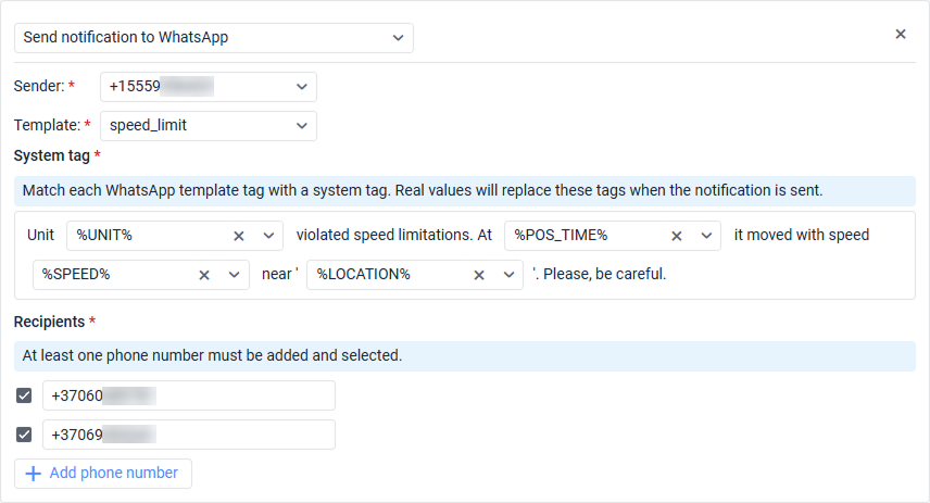

  2. In step 3 (Configure actions), click Add action and select Send notification to WhatsApp.
  3. Configure the action fields. All the fields are required.
  • Sender — select the sender phone number. If more than one number is available, choose the one to use.
  • Template — select a Twilio message template. A tooltip shows the template body preview.
  • System tag — if the template contains variables ({{1}}, {{2}}, and so on), match each variable with a Wialon system tag (for example, %UNIT%, %LOCATION%, %SPEED%).
  • Recipients — specify the phone number in the international format (for example, +370XXXXXXXX) and ensure the checkbox next to it is selected. To enter multiple numbers, click the Add phone number button.
  1. Save the notification.
If a system tag value can’t be determined (for example, %LOCATION% when no coordinates are available), the raw tag name is left in the message. For example, a template “Unit %UNIT% at %LOCATION%” may result in “Unit Mazda at %LOCATION%”.
