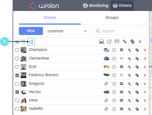

  1. Click on the icon Automatic assignment list icon: Blue square splitting into two arrows toward three grey squares. above the list of drivers.
    The "Drivers" tab interface features a blue branching icon—a square splitting into two arrows toward three stacked squares—used to configure the "Automatic assignment list".
  2. Select the resource for the drivers of which you want to configure automatic assignment. To find out which drivers belong to a certain resource, apply filtering by resource to the driver list (displayed to the right of the Create button). If only one resource is available to you, it is selected automatically.

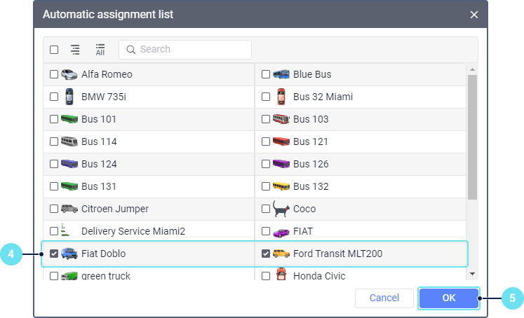

  4. Select the units or unit groups to which the drivers of the selected resource should be assigned automatically. To switch between the lists of units and their groups, use the icon An icon showing four small squares stacked vertically on the left, each next to a horizontal bar, representing a standard list./An icon showing alternating long horizontal bars and indented square-and-bar pairs, representing a nested or grouped list structure.. For more information about the unit selection, see Creating jobs.
  5. Click OK.
    The "Automatic assignment list" window displays a searchable, two-column grid of vehicles where users can select units using checkboxes. The interface includes a top toolbar with view-toggle icons for units and groups, and it concludes with a blue OK button to confirm the assignments.
