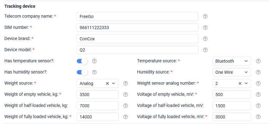

  5. For customers with the Light transport, SFDA and Default activity type, provide information about the tracking device. The required fields are marked with an asterisk (*).
    Field Description
    Telecom company name* The name of the telecom service provider.
    SIM number* The SIM card number of the tracking device.
    Device brand* The brand of the tracking device. Only Latin letters (A–Z) are allowed.
    Device model* The model of the tracking device. Only Latin letters (A–Z) and numbers (0–9) are allowed.
    Has temperature sensor? Enable this option if the vehicle has a temperature sensor. If the customer’s activity type is SFDA, the option is enabled by default.
    Temperature source The connection type of the temperature sensor. The following types are available: Recommended Standard (RS/Serial), One Wire, Bluetooth. This field is visible only when the Has temperature sensor? option is enabled.
    Has humidity sensor? Enable this option if the vehicle has a humidity sensor. If the customer’s activity type is SFDA, the option is enabled by default.
    Humidity source The connection type of the humidity sensor. The following types are available: Recommended Standard (RS/Serial), One Wire, Bluetooth. This field is visible only when the Has humidity sensor? option is enabled.
    Weight source* How the vehicle weight is measured. Select Analog if it’s calculated using an analog sensor or CAN bus / Vehicle computer if the weight value is retrieved from CAN bus. This option is mandatory for all customer activity types except for SFDA.
    Weight sensor analog number The analog input number for the weight sensor. This field is required if the selected weight source is Analog. The available numbers are 1–5. You can clear this field by clicking the cross icon.
    Weight of empty vehicle, kg Vehicle weight when empty, measured in kilograms (kg). Must be a positive integer greater than 0. This field is required if the selected weight source is Analog.
    Weight of half-loaded vehicle, kg Vehicle weight at half load, measured in kilograms (kg). Must be a positive integer greater than 0.
    Weight of fully loaded vehicle, kg Vehicle weight at full load, measured in kilograms (kg). Must be a positive integer greater than 0. This field is required if the selected weight source is Analog.
    Voltage of empty vehicle, mV Sensor voltage reading when the vehicle is empty, measured in millivolts (mV). Must be a positive decimal number greater than 0. This field is required if the selected weight source is Analog.
    Voltage of half-loaded vehicle, mV Sensor voltage reading when the vehicle is at half load, measured in millivolts (mV). Must be a positive decimal number greater than 0.
    Voltage of fully loaded vehicle, mV Sensor voltage reading when the vehicle is at full load, measured in millivolts (mV). Must be a positive decimal number greater than 0. This field is required if the selected weight source is Analog.
