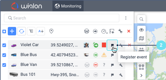

- Make sure that the unit for which you want to register a battery charge is added to the work list on the Monitoring tab and the Event registration option is enabled for the work list.
- Click on the icon
in the row of the required unit to open the event registration window.

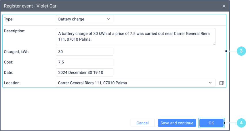

- In the window, select the Battery charge type, specify the amount and cost of the charge, as well as the unit location during charging. The Description and Date fields are filled in automatically, but you can edit them if necessary.
- Save the changes.

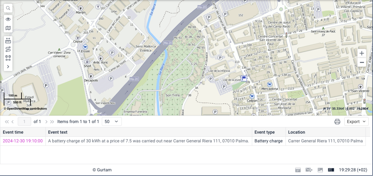

Below is an example of running a report with the Events table. The Registered charge column has also been added to the example in the Adding a table with battery charge data for a specified time period guide.

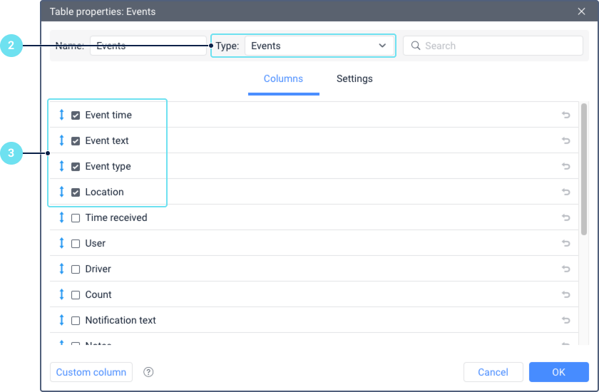

- Click on the New table button and select the Events type.
- Select the columns for the table. In the example, the following are selected:
- Event time. The time specified when registering the charge.
- Event text. The description specified when registering the charge.
- Event type. The type of event, which is a battery charge in this case.
- Location. The location specified when registering the charge.

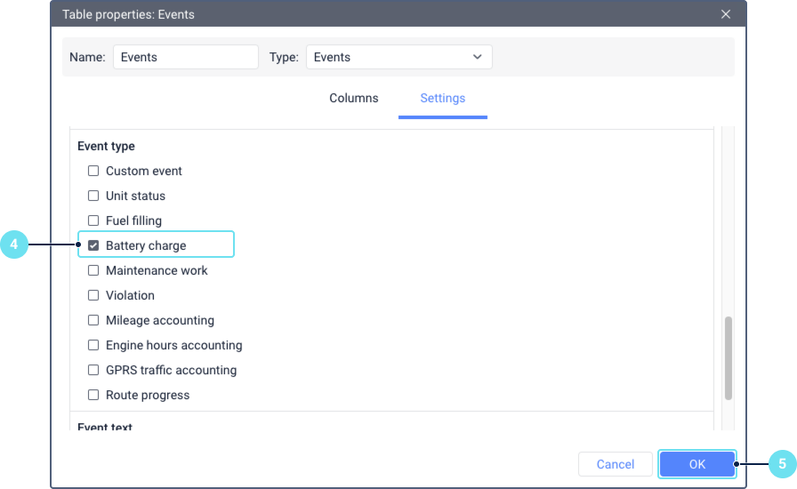

- In the Event type filter on the Settings tab, select Fuel filling to show only these events in the table.
- Click OK to save the table.

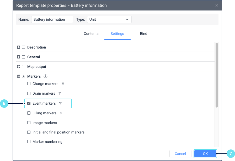

- In the template properties, go to the Settings tab and select Event markers to see the charging location on the map.
- Click OK.

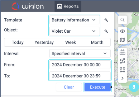

- On the Reports tab, select the created template, the required unit and time period, and click Execute.
Result: The work area displays a table with data on battery charges and a map with markers showing the charging locations.
