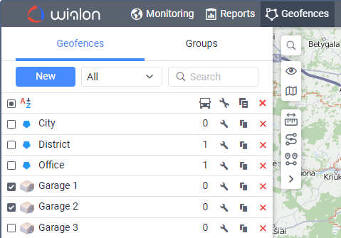

Preparing geofences
To get a report with the Trips between geofences table, you must first create geofences that determine the beginning and end of the trip. The beginning and the end can be the same geofence if the trip starts and ends in one place, for example, if you need to transport cargo from Garage 1 to Garage 2 and this will take more than one trip. Create two geofences and then specify them as the starting and ending points in the report template.

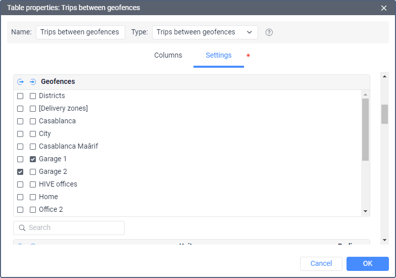

Starting and terminal points
In this section, you choose which geofences and units will be analyzed in the table. You can not only use the geofences from the resource in which the report template is created but also the geofences from other resources to which the user has the View geofences access right. The resource is chosen in the dropdown list above the geofences’ names. You can also select the All option for the list to contain the geofences from all the resources to which the user has the necessary access right. The geofences in the list are sorted by name. To quickly find one, use the dynamic filter.
In addition, you can use units as ‘moving geofences’. For them, you can additionally set the radius of the unit zone. Both geofences and units are arranged in alphabetical order. To quickly find the required item, use the filter. What is more, the beginning of the trip may be in the unit zone, and the end — in the ordinary geofence. For instance, three cars work in the field and harvest, and one takes the crop to the warehouse.

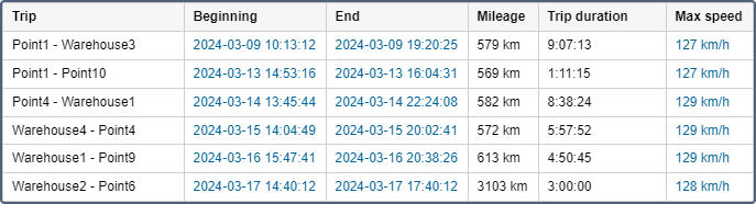

“Trips between geofences” table
The Trips between geofences table gives the list of all performed trips. The table can contain the information described below.
