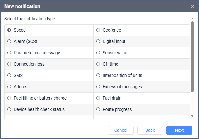

Configuring notification conditions
Conditions are configured in the first step of the notification creation process.
Below are all possible notification conditions and their settings.
