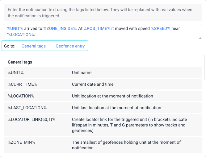

Using tags
You can add tags to the text. These are keywords which will be replaced with real values when the notification is triggered.
A tag must be marked with a percent sign on both sides. Otherwise, it is considered plain text and is not replaced by real values.
For example, entering the text:
%UNIT% arrived to %ZONE_INSIDE%. At %POS_TIME% it moved with speed %SPEED% near %LOCATION%.
is converted to:
Rover119 arrived to Base. At 2025-05-01 12:01:37 it moved with speed 156 km/h near KU 8, Thurnau, DE.
To add a tag to the text, click on it in the list below the text box or enter it manually.

Tag categories and availability
The set of tags available to use depends on the specific condition or conditions you selected in step 1 of the notification setup.
Below the text entry field, tags are grouped into categories, such as General tags and condition-specific tags (for example, Geofence entry). You can click the links next to Go to: to view the relevant list of tags.
General tags
Below is a list of general tags available for most notification conditions.
Tag Description
%UNIT% The name of the unit.
%UNIT_ID% The internal ID of the unit in the system.
%CURR_TIME% The current date and time.
%LOCATION% The unit location at the moment of notification. Determined by the geodata source selected in the settings of the user who created the resource in which the notification is stored. For a Fuel drain condition, the location at the start of the drain is shown.
%LAST_LOCATION% The unit last location at the moment of notification. Determined by the geodata source selected in the settings of the user who created the resource. This tag is useful if the message that triggered the notification doesn’t contain location data.
%LOCATOR_LINK(60,T)% Create locator link for the triggering unit. In brackets, indicate the lifespan in minutes, and use T and G parameters to show tracks and geofences. The default lifespan is 60 minutes. For an unlimited lifespan, enter 0 (zero).
%ZONE_MIN% The smallest of the geofences in which the unit was at the moment when the notification was triggered. The geofence name is displayed instead of the tag only if the geofence and the notification belong to the same resource.
%ZONES_ALL% All the geofences in which the unit was at the moment when the notification was triggered.
