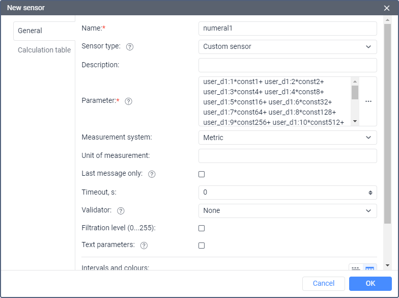

  3. Create a custom sensor numeral_1 in the unit properties in Wialon. In the Parameter field, specify the following formula:
    Copied!
    user_d1:1*const1+ user_d1:2*const2+ user_d1:3*const4+ user_d1:4*const8+ user_d1:5*const16+ user_d1:6*const32+ user_d1:7*const64+ user_d1:8*const128+ user_d1:9*const256+ user_d1:10*const512+ user_d1:11*const1024+ user_d1:12*const2048+ user_d1:13*const4096+ user_d1:14*const8192+ user_d1:15*const16384+ user_d1:16*const32768
  4. Create a custom sensor numeral_2. In the Parameter field, specify the following formula:
    Copied!
    user_d1:17*const1+ user_d1:18*const2+ user_d1:19*const4+ user_d1:20*const8+ user_d1:21*const16+ user_d1:22*const32+ user_d1:23*const64+ user_d1:24*const128+ user_d1:25*const256+ user_d1:26*const512+ user_d1:27*const1024+ user_d1:28*const2048+ user_d1:29*const4096+ user_d1:30*const8192+ user_d1:31*const16384+ user_d1:32*const32768
As a result, the reports and messages in Wialon display the values of two double-byte sensors (numeral_1=56877 and numeral_2=40386) instead of user_d1=2646793773.

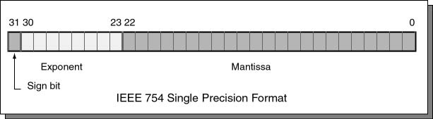

    The formula for the sensor parameter is created on the basis of the formula for converting to the 32-bit IEEE 754 format:
    F=(-1)S2(E-127)(1+M/223)

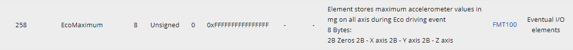

Consider the case of the Teltonika FMT100 device when the io_258 parameter registers the values of the accelerometer on three axes when exceeding the values specified in the device. The data of this parameter is useful when working with the Eco Driving application. In Wialon, the data is registered as io_258=932034904003. The values should be converted into g.
The image below shows the parameter structure.
The values on the axes are signed. In Eco Driving, only the values on the X and Y axes are used. On the X-axis, depending on the sign, the acceleration and braking are determined. On the Y-axis, the transverse acceleration is determined which will be used as an absolute value (module) because the sign (left/right) is not taken into account in Eco Driving.

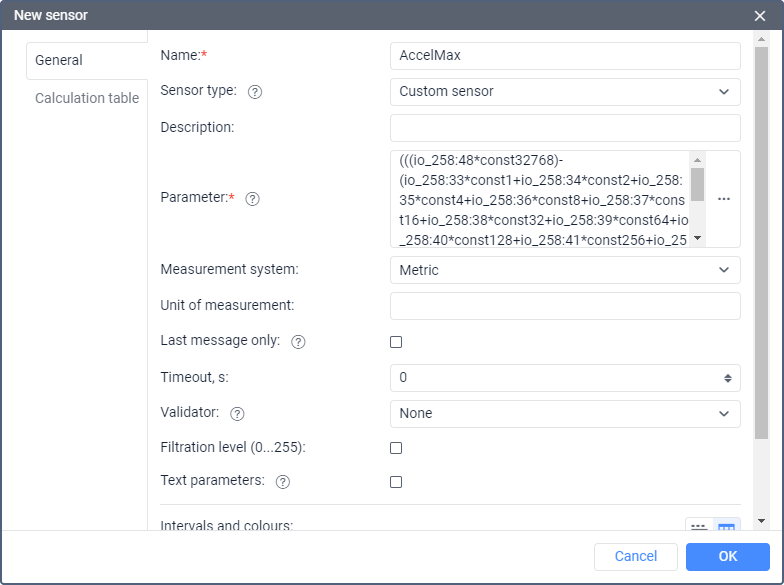

  1. Create a custom sensor Accel_MAX in the unit properties in Wialon. In the Parameter field, specify the following formula :
    Copied!
    (((io_258:48*const32768)-(io_258:33*const1+io_258:34*const2+io_258:35*const4+io_258:36*const8+io_258:37*const16+io_258:38*const32+io_258:39*const64+io_258:40*const128+io_258:41*const256+io_258:42*const512+io_258:43*const1024+io_258:44*const2048+io_258:45*const4096+io_258:46*const8192+io_258:47*const16384))*io_258:48)/const1000

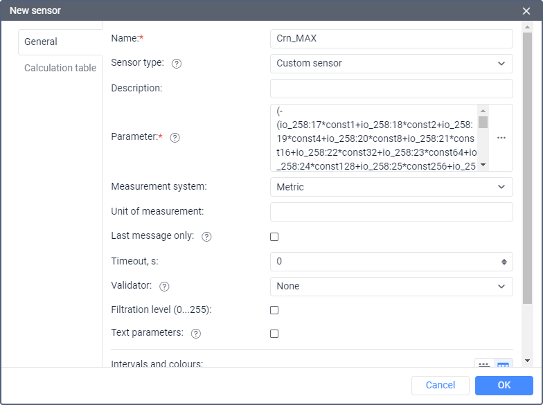

  3. Create a custom sensor Crn_MAX. In the Parameter field, specify the following formula:
    Copied!
    (-(io_258:17*const1+io_258:18*const2+io_258:19*const4+io_258:20*const8+io_258:21*const16+io_258:22*const32+io_258:23*const64+io_258:24*const128+io_258:25*const256+io_258:26*const512+io_258:27*const1024+io_258:28*const2048+io_258:29*const4096+io_258:30*const8192+io_258:31*const16384))*(io_258:32-const1))/const1000+(((io_258:32*const32768)-(io_258:17*const1+io_258:18*const2+io_258:19*const4+io_258:20*const8+io_258:21*const16+io_258:22*const32+io_258:23*const64+io_258:24*const128+io_258:25*const256+io_258:26*const512+io_258:27*const1024+io_258:28*const2048+io_258:29*const4096+io_258:30*const8192+io_258:31*const16384))*io_258:32)/const1000
    Two bytes are provided for the Y-axis. The bit numbers in Wialon are from 17 to 32. Since the module (absolute) values are taken into account, the formula is a little longer than the previous ones.
