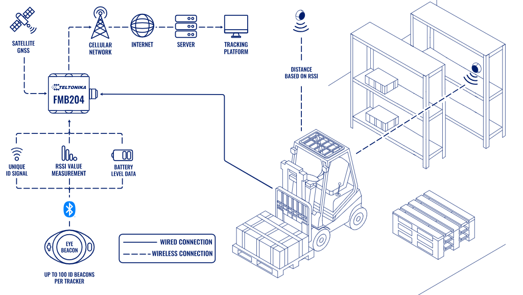

This article describes how to configure Teltonika devices for online indoor positioning based on data from BLE ID sensors. This configuration can be used for:
The configuration process includes the following stages:

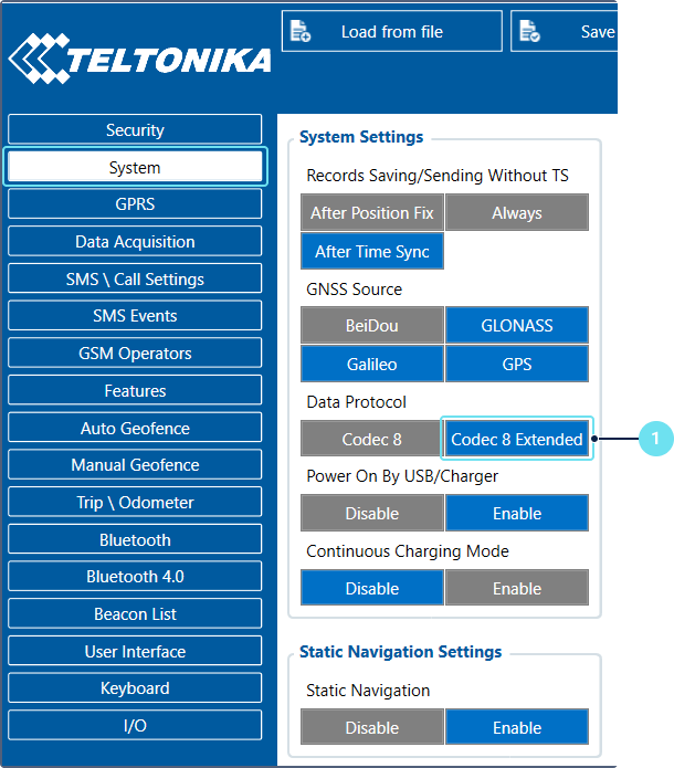

  1. On the System tab, activate the Codec 8 Extended protocol to get the beacon data.

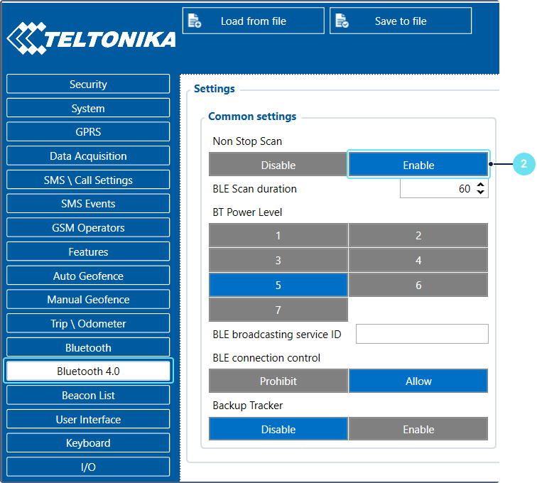

  2. On the Bluetooth 4.0 tab, enable the Non stop scan option.

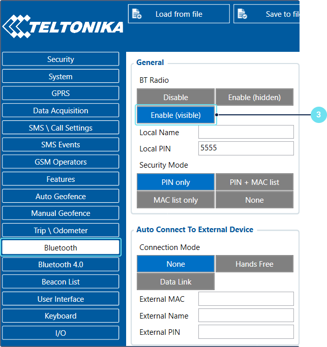

  3. On the Bluetooth tab, enable the BT radio option.

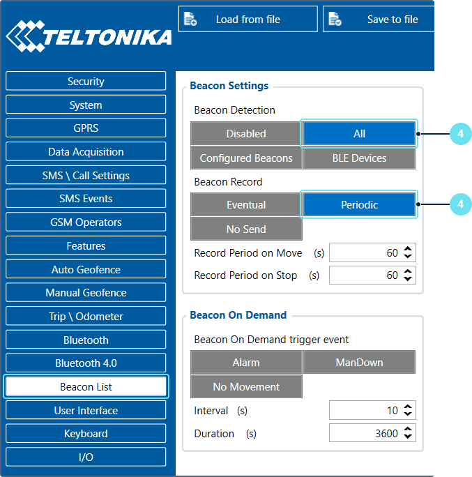

  4. On the Beacon list tab, select All for the Beacon detection option and Periodic for Beacon record.

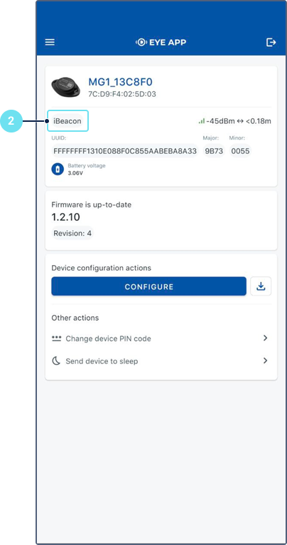

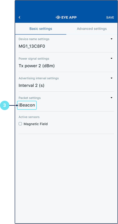

Changing the data format
To change the data format for the beacon, follow the steps below.
  1. Download the Eye app, a Teltonika application for changing sensor settings. It is available in Google Play and App Store.
  2. In the application, tap the packet type.
  3. Select the necessary data format from the list.
The selected data format is applied to the beacon configuration.

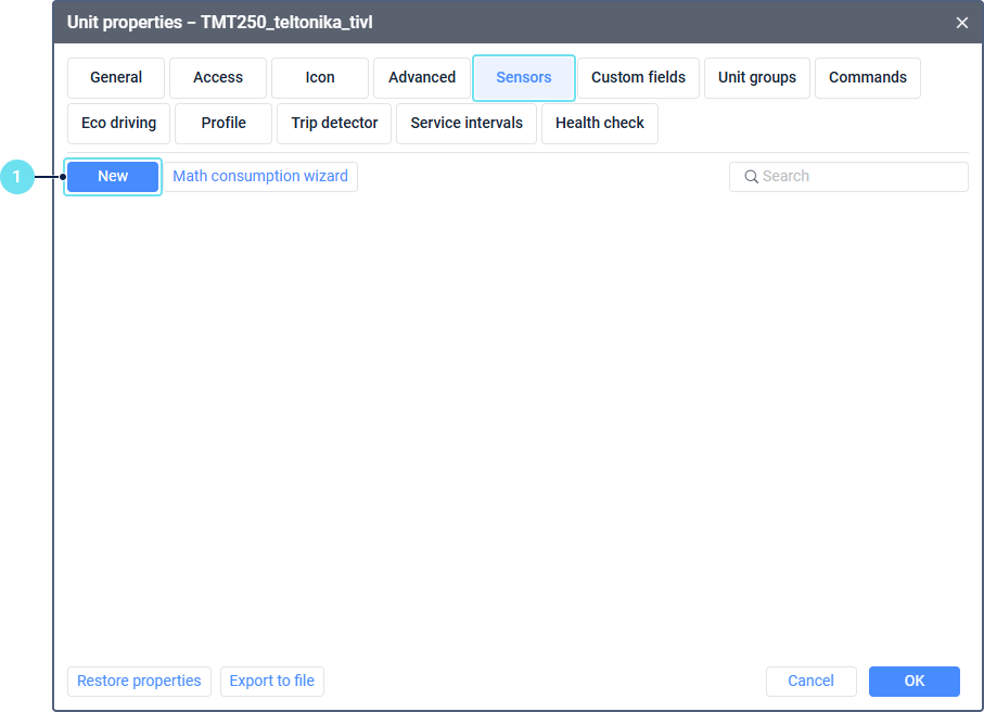

Configuring the sensor in Wialon
After a successful configuration, the beacon parameters are displayed in the unit tooltip or extended information in Wialon (if the Parameters option is activated in the user settings).

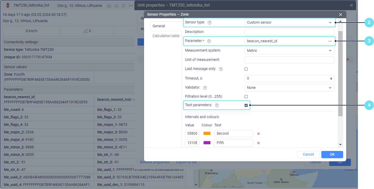

The next step is to create a sensor with the beacon_nearest_id parameter. To do this, open the unit properties (screwer icon) and follow the instructions below.
  1. On the Sensors tab, click New.
  2. Select Custom sensor as the sensor type.
  3. Specify beacon_nearest_id as the sensor parameter.
  4. Enable the Text parameters option.
  5. Set intervals and colors with values of the ble_uuid parameters.
  6. Click OK.
After this, the device can be used for online indoor monitoring in Wialon.
