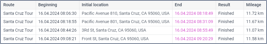

The Rides table (for a unit) contains information about routes travelled by a unit. The table can generated if any routes were assigned to a unit and events about routes were stored in the unit history.
The Rides table (for a unit) can contain the columns described below.
