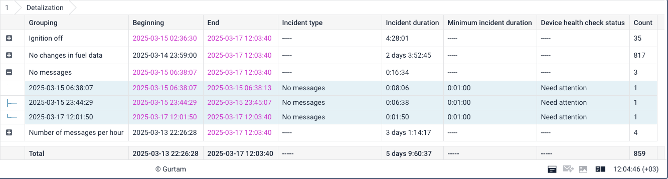

Each row of the table represents a separate interval of an event related to a specific uninterrupted incident. For example, if a unit device experiences a low battery incident continuously for several hours, it will be displayed as a single row in the table.
The Health check incidents table can be included in reports on units and unit groups. You can see the total number of incidents in the Statistics table.

Incident type The type of incident that occurred. Possible types are:
  • No GPS data
  • Number of satellites.
  • Device battery level
  • Voltage level
  • Number of messages per hour
  • No messages
  • Distance between messages
  • No changes in fuel data
  • Ignition off
The table shows those types of incidents that are currently tracked. See how to configure criteria for tracking incidents on the Health check tab.

Health check table example with grouping by incident type
