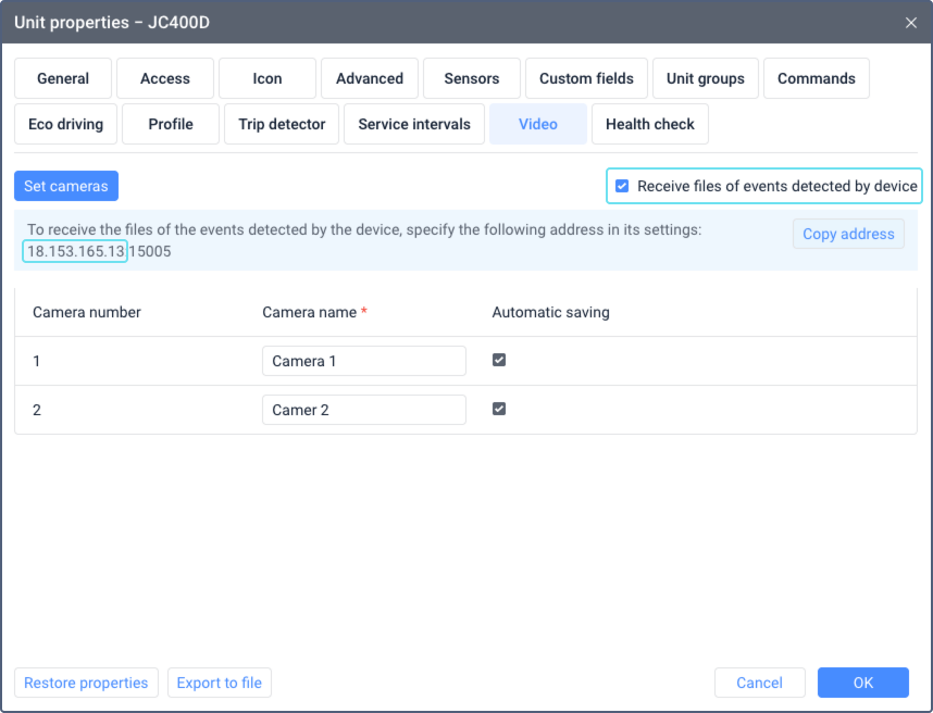

When using the JC400D, consider the following:
  • For the JC400D firmware, contact the manufacturer.
  • In order to get videos of the events generated by the device, enable the Receive files of events detected by device checkbox in the Video tab of the unit properties. After that, send the upload command with the address displayed after enabling the checkbox, for example: UPLOAD,http://18.153.165.13:15005/
