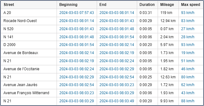

The Visited streets table shows what streets were visited and when. Highways, roads, and other places with available addresses are also considered as streets in this table.
Below are the columns which can be presented in the Visited streets table.
Column Description
Street The name of the street, road, highway, etc.
Initial location The place where the first message from this street was received. It can be the same as the previous cell or more detailed (for example, it can additionally contain a house number).
Beginning The time when the unit started moving along the street.
End The time when the unit left the street.
Driver The name of the driver assigned to the unit while visiting the street.
Duration The total time the unit was on the street.
Mileage The distance that was travelled by the unit while moving along the street.
Mileage (adjusted) The mileage subject to the coefficient set in advanced unit properties. More information about mileage in the report can be found here.
Avg speed The average speed while moving along the street. See how the average speed is calculated on the Data in reports page.
Max speed The maximum speed detected while moving along the street. More information about speed in reports can be found here.
Streets count The number of performed visits (can be helpful if there is grouping by years/months/weeks/days/shifts).
Notes An empty column for your custom comments.
When clicking on a coloured cell in the table, the map is moved so that to display a point where the unit entered or left the indicated street, or reached the maximum speed.
Sometimes there can be gaps in cells. This means that only one message was received on this street, and therefore it is difficult to determine the length of time it was on the street, the mileage, and the average and maximum speed.
Interval filtering by duration, mileage, engine hours, speed range, trips, stops, parkings, sensors, drivers, fuel fillings, fuel drains, and battery charges can be applied to the Visited streets table. For example, you can display only the streets where a particular sensor was turned on or the streets where the sensor was turned off. To specify the sensor, you can set a mask for it. This function is convenient, for example, for snow removal equipment — it allows you to know that the car did not just pass along the street, but had the brushes on.
