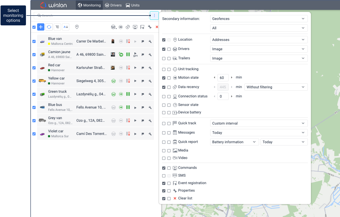

To customize the list, press the icon
in the upper right corner of the Monitoring tab. In the left column, select the options that should be displayed in the work list and in the monitoring options menu. In the right column, you can select the options that are used more rarely — they will be shown in the additional menu and will be available there. The customized list is saved and applied for each user individually.
All the options on the Monitoring tab can nominally be divided into two types described below.
Information options. These icons contain some information about the current state of the unit (movement/stop, sensor value, connection status, data recency). For additional information, see the tooltip which appears when you point to the icon.
Action options. A click on these options allows performing an action on the unit (event registration, command or report execution, message request, track building, properties editing, removal from the work list, etc.). As a rule, all further instructions can be found in the corresponding dialog boxes. Active action buttons turn blue when you point to them.
The icons in the upper part of the work list can also be used. In some cases, it allows you to sort the units according to some properties (for example, the moving units are at the top, the stationary units are at the bottom, and vice versa).
Secondary information
All the options on the Monitoring tab are divided into 5 sections. The first one contains the Secondary information option, which allows displaying the contents of the text columns under the unit names. The following alternatives are possible:
