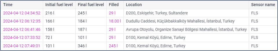

The Fuel fillings and battery charges table can contain the columns described below.
Column Description
Beginning The date and time when a fuel filling or battery charge began. When coordinates are available, clicking this value displays the start location on the map.
The grouping rows (group headings) show the beginning of the first fuel filling or battery charge of the group. The Total row shows the beginning of the first event within the report interval.
End The date and time when a fuel filling or battery charge ended. For ongoing events, the end time is displayed based on the Incomplete interval setting. When coordinates are available, clicking this value displays the end location on the map.
The grouping rows (group headings) show the end of the last fuel filling or battery charge of the group. The Total row shows the end of the last event within the report interval.
Filling or charge time The moment of the most significant change in the fuel level or battery level.
Location The location of the unit at the time of filling or charge (if a filling or charge is registered manually, the location of the unit is detected on the basis of the messages received at the time of registration).
Initial fuel level The fuel level before the filling.
Final fuel level The fuel level after the filling.
Filled The volume of filled fuel (the name of the sensor can be indicated in parenthesis).
Registered filling The volume of a fuel filling registered manually on the Monitoring tab.
Filling difference The difference between the detected and registered filling volume.
Initial battery level The battery level in kWh before charging.
Final battery level The battery level in kWh after charging.
Charged The amount of energy used to recharge the battery, in kWh.
Registered charge The volume of a battery charge registered manually on the Monitoring tab, in kWh.
In order for the volume of a charge registered manually and the same charge detected automatically to be shown in one row and compared, their times must match or the time difference must be no greater than the number of minutes specified in the Deviation field. For more information, see the General page.
Charge difference The difference between the charge volume registered manually and the charge volume calculated automatically using the battery level sensor.
Description A brief description indicated during the manual registration of fuel filling or battery charge.
Sensor name The sensor which detected the fuel filling or battery charge.
Driver The name of the driver (if identified).
Trailer The name of the trailer (if it was assigned).
Filling count The number of fuel fillings. This column is recommended when grouping rows by days/weeks/months or for reports on groups of units.
Charge count The number of fuel fillings. This column is recommended when grouping rows by days/weeks/months or for reports on groups of units.
Counter The indications of the counter sensor.
Mileage The mileage sensor value at the moment of filling. If the mileage parameter was not saved throughout the reported period, the mileage is counted from 0.
Avg. value of custom sensor The average value of the custom sensor registered during the filling.
This and the following columns of custom sensor values show a dash if the sensor parameter has a text value or the value is invalid. For example, if the value is not within the bounds set in the calculation table.
Min. value of custom sensor The minimum value of the custom sensor registered during the filling.
Max. value of custom sensor The maximum value of the custom sensor registered during the filling.
Initial value of custom sensor The value of the custom sensor registered before the filling.
Final value of custom sensor The value of the custom sensor registered after the filling.
Notes An empty column for your custom comments.
Video Files saved during the filling using the Video module. To watch them, click on the icon (the number of grouped files is indicated to the right of it, if several). If several grouped files are available, you can select the required one in the drop-down list in the upper-left corner.
The column is available if the Video monitoring service is activated in the account properties.
Image The images received from the unit. Viewing images in reports and the functions available while doing this are described here.
If you use grouping or the Total row in the Fuel fillings and battery charges table, the values in the grouping and Total rows are calculated in accordance with the grouping value selected for each column.

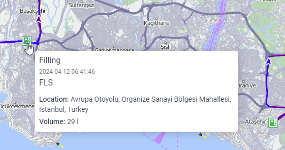

You can use special markers for this report to mark places of fillings and battery charges on the map.
