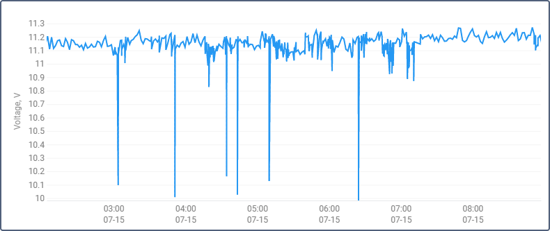

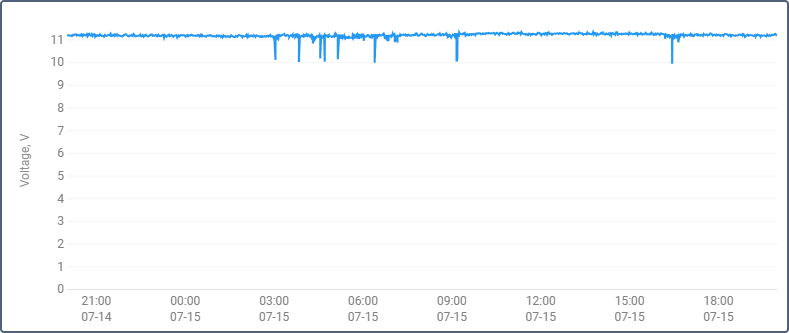

The Count from zero option is responsible for scaling the chart. By default, the range of the Y scale depends on the range of values falling within the specified interval. That is, if, for example, the temperature fluctuates from 3 to 5 degrees, then the reading on the Y scale starts at 3, and the line, in this case, occupies the maximum space on the chart. If the Count from zero option is activated, the Y-axis on the graph is always built from zero to the largest value (if the values ​are negative, then from the lowest value to zero).
The image below shows an example of two voltage charts for the same unit within the same time interval. The first chart is regular; the second has the Count from zero option turned on.

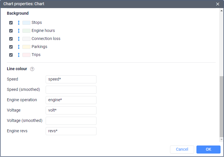

Background
The intervals of such events as stops, parkings, trips, connection losses, and work of engine hours can be used as a chart background. Using these backgrounds you can correlate a chart value and an interval to which it corresponds. Different colors can be assigned for the event intervals. To select a color, click on the color box, choose the color from the palette and click OK.
The background of the event intervals is opaque and has a display priority, that is, the interval above is overlapped by the lower ones. To change the priority, drag the desired interval of events up or down using the double arrow icon to the left of the name of the desired interval.

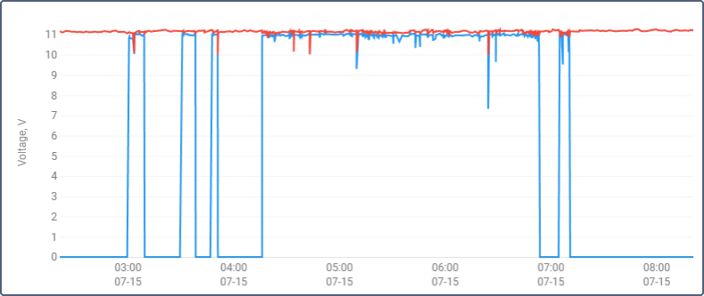

Line color
For each line selected on the Data tab, you can specify a sensor, the readings of which should affect the line color in the chart. To do this, type the sensor name or its mask in the field next to the name of the line. Colors and the value ranges corresponding to them are configured in the sensor properties.
The shape and color of the line can depend on the same sensor or two different ones.
Example 1. A sensor of the Fuel level sensor type is specified for the Fuel level line. In this case, the shape and color of the line are based on the same sensor.
Example 2. A sensor of another type, for example, Voltage sensor, is specified for the Fuel level line. In this case, the shape of the line corresponds to the fuel level, while its color represents voltage values.
