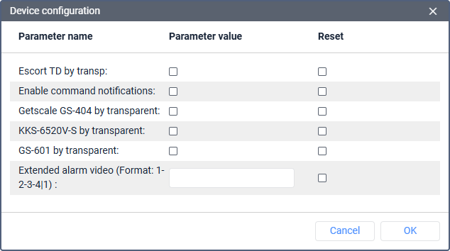

Additional settings
Additional device settings are available in the unit properties upon clicking on the icon
next to the Device type field.
The available settings are as follows:
| Setting | Description |
| Escort TD by transp | Enable this option if you want to receive data from Escort TD additional equipment. |
| Enable command notifications | Enable if you want to receive command responses in a pop-up window. |
| Getscale GS-404 by transparent | Enable this checkbox if you are using Getscale GS-404 RFID reader. Parameters with the prefix gs_404_ are registered. |
| KKS-6520V-S by transparent | Enable this checkbox if you are using the KKS-6520V-S RFID reader. Parameters with the prefix kks_ are registered. |
| GS-601 by transparent | Enable this checkbox if you are using Getscale GS-601 keyboard. Parameters with the prefix rfid_ are registered. |
Extended alarm video (Format: 1-2-3-4|1) |
Configure which channels record video when an alarm is triggered. Use 1-2-3-4 for the camera channels you want to use; After the vertical bar, use 1 for recording mode (0 for photo only, 1 for video only). Example: 1-2|1 means channels 1 and 2 record video (not photos) when an alarm is triggered. |
