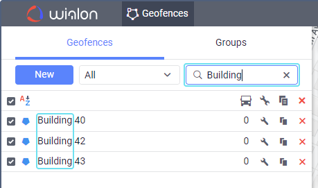

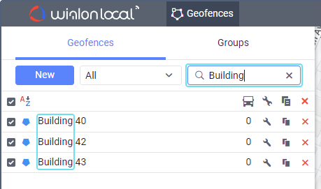

If the list contains many items, it may be difficult to quickly find the required one. For convenience, you can use the dynamic search available on most tabs. Start entering the name of the object (geofence, unit, route, and so on, depending on the active tab). You can type just a part of the name. As you enter the text, the list shows the items that match your query. The search is not case-sensitive.
If you leave the filter field empty, all the available items will be displayed in the list.

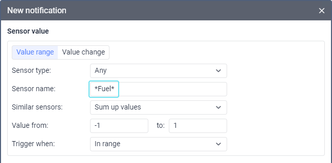

Suppose that a unit has two fuel sensors with the names Fuel level sensor and Fuel in tank. You should create a notification that takes into account the values of both sensors. To do this, you should set the name mask that matches both of the sensors. In this case, the best choice is *Fuel*.

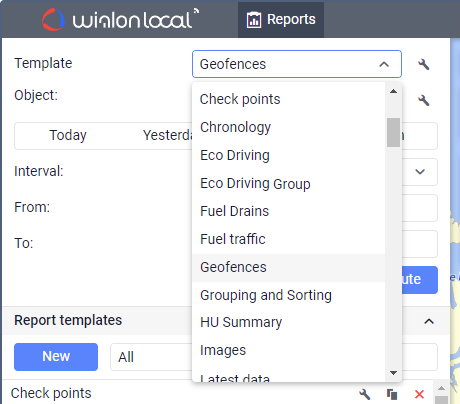

When building tracks or querying messages and reports, you can use dynamic search in dropdown lists. For tracks and messages, you can quickly find a necessary unit in the dropdown list, for reports you can find templates or objects. To use the dynamic search, click the corresponding dropdown list and start entering the name. You can use a wildcard character asterisk (*) to facilitate the search. As a result, the dropdown list is filtered according to the indicated symbols.
To work with the dropdown list, you can use a keyboard. Use arrows (up/down) for navigation through the list and the Enter key for choosing a necessary item.

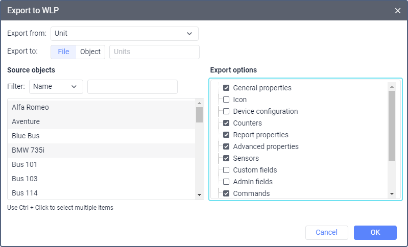

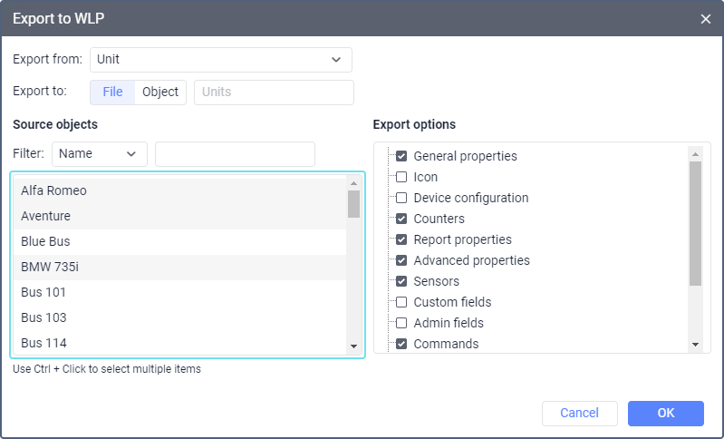

Multiple selection list box
In the lists of such type, you can select multiple items. To choose several items throughout the list, hold the Ctrl button, and consequently click on the necessary items.
