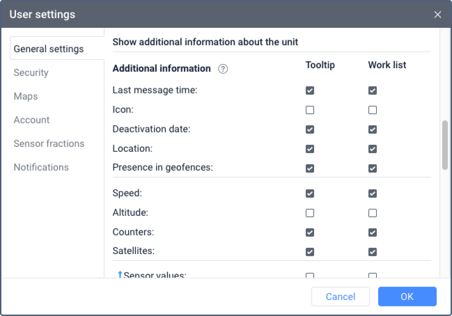

Show additional information about units
In this section, you can configure additional information about the unit. The items selected in the Tooltip column determine the contents of the unit tooltip, while those selected in the Work list column determine the contents of extended information about the unit in the work list.
To select or cancel the selection of all the items in a group, click on any item in the required column while holding down the Ctrl key.
You can change the order of the items to the left of which the icon  is shown. To do this, drag the icon up or down.
