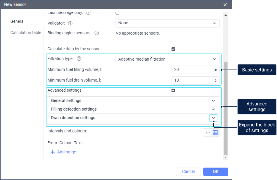

Basic settings
The basic settings of the fuel level sensor include three options.
Filtering type
This option allows smoothing the sensor values to avoid data outliers (sudden changes in the fuel level: rises or falls).
Filtering of FLS values is taken into account in reports (in tables and charts when displaying smoothed lines), in jobs for sending fuel level information, and in notifications about fuel fillings and drains.
The drop-down list contains three items:
| Item | Description |
| None | Select this item if the data doesn’t require filtering. |
| Median filtering | If you select median filtering, you should specify its level, that is, how much the data should be smoothed. For information about this type of filtering and the selection of a suitable filtering level, see Median filtering of FLS values. |
| Adaptive median filtering | If you select adaptive median filtering, no additional settings are required. The algorithm automatically selects a suitable value based on the unit data. The algorithm smoothes small random fluctuations in fuel level without affecting significant variations. This allows detecting fuel fillings and potential drains more efficiently and determining their volume more accurately. |
The unit tooltip and the extended unit information show raw FLS values, that is, the values which haven’t been filtered yet.
Minimum fuel drain volume
The minimum decrease in the fuel level which should be considered a drain. The value of this field should be greater than 0 and can be fractional.
Minimum fuel filling volume
The minimum increase in the fuel level which should be considered a filling. The value of this field should be greater than 0 and can be fractional.
Advanced settings
The system uses default values for the advanced settings, but you can change them if needed. To do this, activate the Advanced settings option and edit the values in the General settings, Filling detection settings, and Drain detection settings blocks. If the Advanced settings option is deactivated, the edited values are replaced by the default ones.
