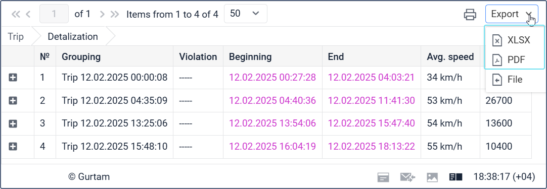

Instant export
You can save a report in XLSX or PDF format following these steps:
  1. Click on Export in the toolbar of the generated report.
  2. Select the XLSX or PDF format in the dropdown list.
  3. Open the file or save it to the disk depending on your browser settings.

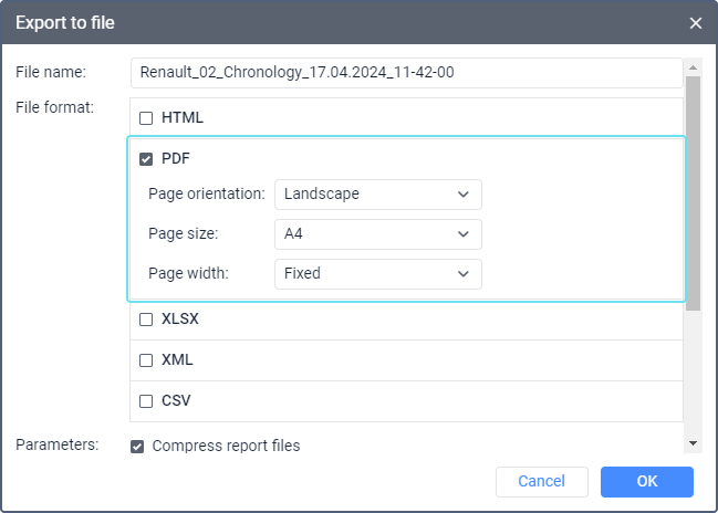

Export with settings
You can get the same report in several files of the available formats. To do this, follow these steps:
  2. Select the File option.
  3. If necessary, change the file name generated automatically.
  4. Select the necessary formats. For PDF and CSV, additional settings are available in the menu.
  5. Specify the required parameters.
  6. Click OK.
  7. Depending on your browser settings, open the file or save it to the disk.

When exporting the report to a PDF file, the following additional options are available:
Option Description
Page orientation Select the page orientation: portrait or landscape.
Page size Select the page size: A4 or A3.
Page width This option is useful for reports with many columns. You can select one of the following options:
  • Fixed. The page width depends on the selected page orientation and size. If the width of a table doesn’t fit, the report is exported without this table (only its title is shown).
  • Auto, compact. The width of a table cell is equal to the width of the widest word in a column.
  • Auto, no wrap. The width of a table cell is equal to the width of the longest row (without line wrapping).
