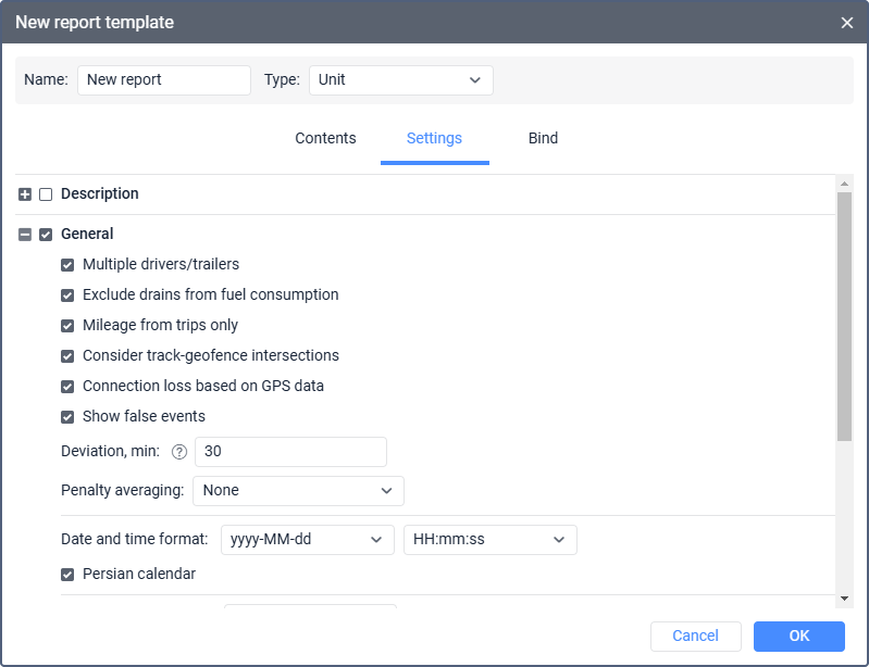

General
In the General section, you can configure the date and time format, select the measurement system and the thousand separator, and, depending on the type of report, activate other options described below.
Skip empty rows
This option is available for the Unit group and Group of drivers report types. When the option is enabled, it hides rows that don’t contain any data. When disabled, all the rows are shown.
The Skip empty rows option is enabled by default for the Group of drivers report type. The option is applied only to the drivers assigned to a unit during the report interval.
Example. You need to generate a report with an Eco driving table on the group of 30 assigned drivers. The enabled Skip empty rows option hides the rows of drivers with no violations. To see all the drivers of the group, even those without violations, disable the option.
Multiple drivers/trailers
If the report template contains a table with the Driver or Trailer columns, then when this option is activated, they display all the drivers or trailers that were assigned to the unit.
If this option is not activated, the columns show only the driver or trailer that was assigned first. However, if two drivers were assigned to the unit, and then the second of them was separated, the column shows a dash instead of the driver assigned first. In such a case, use the following solutions so that the information is displayed correctly:
- separate the first driver from the unit and assign this driver again;
- enable the Exclusive option in the driver properties;
- activate the Multiple drivers/trailers option in the report settings.
These actions are also applicable to trailers.
Mileage from trips only
This option affects mileage calculation. If the checkbox is not marked, the mileage is calculated according to all messages without any filtering. If the checkbox is marked, only the part of the mileage that is considered a trip is taken into account.
Consider track-geofence intersections
This option allows you to detect a visit to a geofence in case the trip had an intersection with the geofence by any segment of its track. This option can be applied to such reports as Geofences, and Trips between geofences.
Connection loss based on GPS data
This option can be applied to the Connection loss and Chronology tables, as well as to charts when selecting the background of connection loss. If this option is enabled, the absence of messages during the time exceeding the value in the Maximum interval between messages field is considered as a connection loss.
If the option is disabled, the following intervals are also considered as a connection loss:
- without messages from the unit
- with messages without coordinates
- with messages with the number of satellites equal to 0
Show false events
If the option is activated, the reports show fillings and drains marked by the user as false. They can be seen in the Fuel drains, Fuel fillings, Fuel traffic and Chronology tables, as well as on the tracks in the report and on the chart of Normal type. Such a mark can be set only in the Fuel fillings and Fuel drains tables or in the Regular chart.
In the report table the rows with false events are marked with strikethrough font and blurred background. On the chart and on the track, false fillings and drains events are marked with markers
and
If the Show false events option is disabled, false fillings and drains are hidden in all places in the interface.
If the option Show false events is enabled, the marks of false fillings and drains are not shown in the grouping and Total rows. The values in these rows are shown without changes, that is, as if these marks did not exist. Switch off the option so as the data on drains, fillings and fuel consumption could be shown in the grouping and Total rows taking into account the marks.
The option does not affect the calculation of other data in the report, nor does it affect the fillings and drains markers when watching the playback in the Video tab.
Deviation

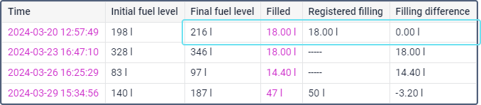

The possible deviation from the specified filling or charge time in minutes. This value is used for the Fuel fillings and battery charges table to compare the fillings and battery charges registered manually and those detected automatically.
If the same filling has been automatically detected by a fuel sensor and registered manually, the Fuel fillings and battery charges table shows the volume data in one row in the Filled and Registered filling columns respectively. Also, the table shows the difference between the values of these columns.
In order for the volume data to be shown in one row, the time of the filling detected automatically must be the same as the time specified when registering the filling manually. The time of a filling detected automatically is the time of the maximum change in the fuel level.
If a value is specified in the Deviation field, the time of the filling registered manually may be different from the time of the one detected automatically. It may be earlier or later, but the difference must not exceed the value specified in this field.
Example. A fuel filling has been detected automatically. Its time (the time of the maximum fuel level difference) is 12:57:49. When registering the filling manually, the user specifies 12:55:00 in the Date field and 30 minutes in the Deviation field. Since the difference is about 3 minutes and doesn’t exceed the value in the Deviation field, this filling is considered one and the same. The filling volume determined automatically is shown in the Filled column, and the volume specified manually is shown in the Registered filling column in the same table row.
The same logic is applied to battery charges. The value determined by the battery level sensor is shown in the Charged column, and the value registered manually is displayed in the Registered charge column.

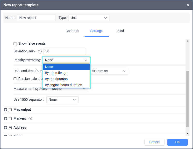

Penalty averaging
The Penalty averaging setting is used for the following tables:
- Eco Driving
- Geofences
- Counter sensors
- Engine hours
- Unfinished Trips
- Trips
- Trips between geofences
- Summary
- Digital sensors
- Statistics
The setting allows choosing how penalty points are calculated in the grouping rows of the table. The averaging doesn’t apply to the individual rows of violations.
Select one of the available options to calculate averaging:
- None. The averaging option is disabled. All the penalty points of the grouping interval are summed up.
- By trip mileage. The total number of penalty points added for the grouping interval is divided by the number of kilometers traveled during the trips. Therefore, the system determines the average number of penalty points for each kilometer of the trip.
- By trip duration. The total number of penalty points added for the grouping interval is divided by trip duration. Therefore, the system determines the average number of penalty points for each minute of the trip.
- By engine hours duration. The total number of penalty points added for the the grouping interval is divided by the engine hours time in minutes. The system determines the average number of penalty points for each minute of the engine use. The data is retrieved from the engine hours counter. For this, you must have a sensor of one of the following types: engine ignition sensor, absolute engine hours sensor and relative engine hours sensor.
Averaging by trip mileage and by trip duration doesn’t apply to the intervals if their duration is less than a minute.
See more about penalty averaging on the Eco driving table page.
