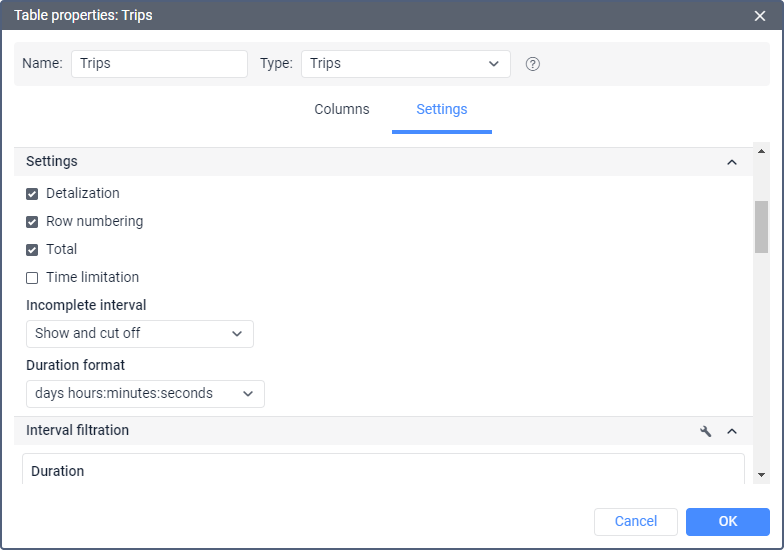

Settings
The following settings are available in this section:
- Detalization
- Row numbering
- Total
- Time limitation
- Interval type
- Incomplete interval
- Additional parameters
- Duration format
- Unit group data
These settings are universal for all the table types. However, individual parameters can be applied to some of them, which is described for each table separately.

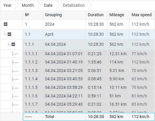

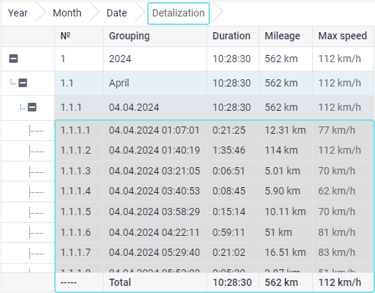

Detalization
Reports with grouping can be extended using the detalization option. Detalization gives an opportunity to move to a final level of nesting (date and time). To view the final level of nesting, you can open (‘+’ at the beginning of the line) all the previous levels one-by-one, or click on the corresponding level of nesting.
We can add detalization in the report (check the corresponding box in the table parameters), suggested below as an example of grouping and sorting use. Since in this example we already have grouping by years, months and dates, the detalization will allow us to expand the level of nesting right before the time of the event (hours, minutes, seconds).
It should be noted that sorting is applied to the nested level. Since the detalization is the final level of nesting, you can also set the sorting for detalization in the list of groupings in a similar way.
The detalization function is applied only to the grouped tables, not the detailed ones. The exception is the reports on groups of units, drivers, trailers, and passengers, as the grouping by units is provided in them by default.

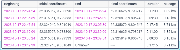

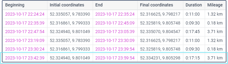

Incomplete interval
The Incomplete interval option does not apply to all intervals of the table, but only the last (trips, sensor operation, etc.), since its ending does not always coincide with the end of the reporting period. To display this interval, the following options are provided.
| Option | Result |
| Show and cut off | The interval is displayed in the report. The End column shows the time of the last message in the reporting period.![]() |
| Do not show in report | The incomplete interval is not displayed in the report.![]() |
| Show and mark as incomplete | The interval is displayed in the report and has the Unknown label in the End column.![]() |
