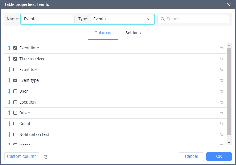

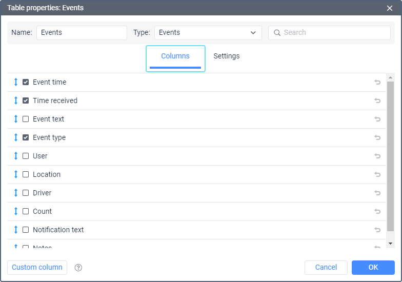

Selecting columns
The set of available columns depends on the selected table type. To add a column to the table, check the box to the left of its name. To add all columns at once, hold down Ctrl and mark any column which is not selected. You can cancel the selection of all columns in the same way. To quickly search for columns, use the dynamic filter in the upper-right corner.
To edit the name of a column, click on it with the left mouse button. To use the default name of the column, click on the icon in its line. The icon is inactive is the default name is used.
If necessary, you can change the sequence of columns in the table. To do this, click on the icon   to the left of a column and drag it to the required place while holding down the left mouse button.

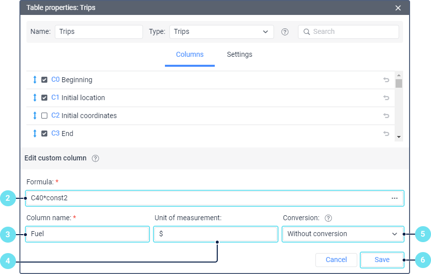

Adding custom columns
You can add custom columns to all the tables except for Images and Video. They are used to calculate values on the basis of data from other columns, unit parameters, the report interval, and so on. Custom columns can also display text values such as the unique ID, profile properties of the unit, and text values of custom fields.

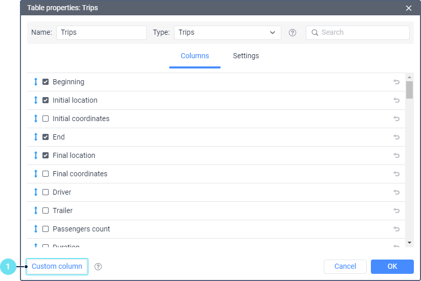

To add a custom column to the table, follow the steps below.
  1. On the Columns tab of the table properties, click on the Custom column button.
  2. Specify the formula for calculating the column value. See the description of the available formula components.
  3. Specify the name of the custom column.
  4. Indicate the unit of measurement (up to 10 characters).
  5. If the table supports grouping values, select the one you need for the column. By default, the Formula-based calculation value is used. See Grouping value for custom columns.
  6. If you use the custom column to calculate duration, select how it should be displayed in the Conversion drop-down list. See the available conversion options.
  7. Click Save.

Formula example: (C1+C2+C7)*const1.5/rcoef

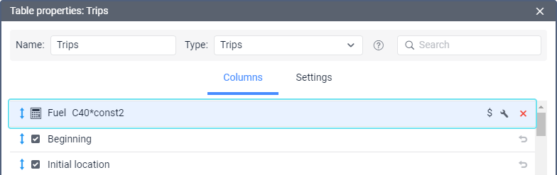

Editing custom columns
The created custom column automatically goes to the top of the list. However, you can change its position by dragging if necessary. Such columns are highlighted in blue and don’t have an index.
To edit the created column, click on the icon wrench icon, column name, formula, or unit of measurement, make the necessary changes and save them.

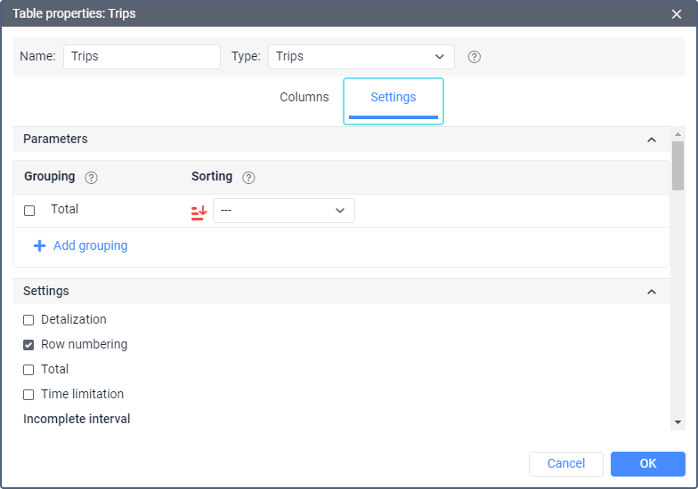

Table settings
For each table, in addition to selecting columns, there are additional settings, located in the same-name tab.
The tab is divided into three sections:
