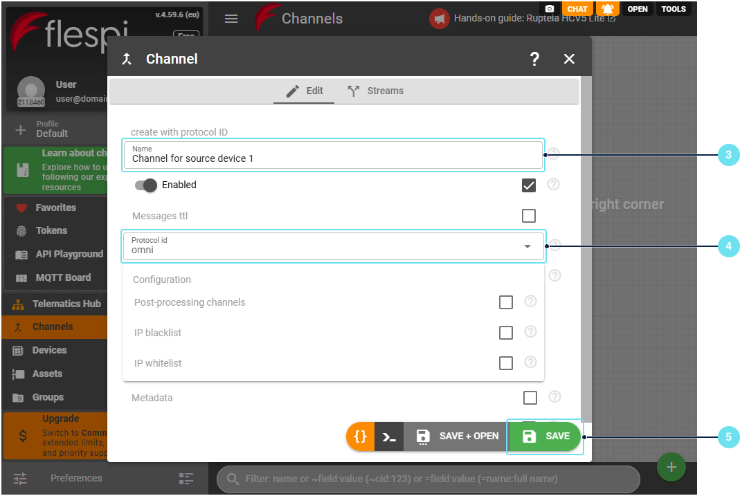

Creating channels on flespi
To create a channel on flespi, follow the steps below.
  1. In the Telematics Hub, select Channels.
  2. Click the button white plus in a green circle.
  3. Enter the channel name.
  4. Select the protocol matching your device.
  5. Click Save.
  6. Repeat steps 1-5 for the second device if it uses a different protocol.
  7. Save the host:port of the channels. You will need them to configure physical devices.

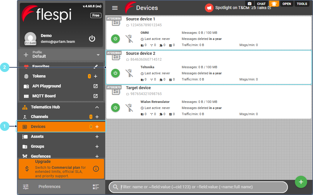

Creating devices on flespi
To create a device on flespi, follow the steps below.
  1. In the Telematics hub, select Devices.
  3. Enable the Device name option and enter the device name.
  4. Select the device type.
  5. Enter the device identifier (usually IMEI).
  6. Click Save.
  7. Repeat steps 1-6 for the second device.
  8. Configure physical trackers to send data to the host:port of their respective channels.
  9. Create another device that will be the target for merged data.

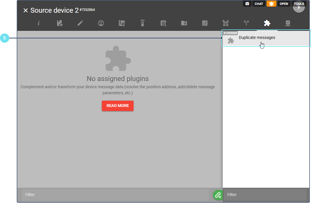

Assigning the plugin to the devices
Assign the plugin to both source devices, following these steps:
  2. Select the device.
  3. Go to the Plugins tab.
  4. Click the clip button in the lower-right corner.
  5. Select the created plugin.
  6. In the Device ID where to copy messages field, specify the ID of the target device.
  7. Click Save.

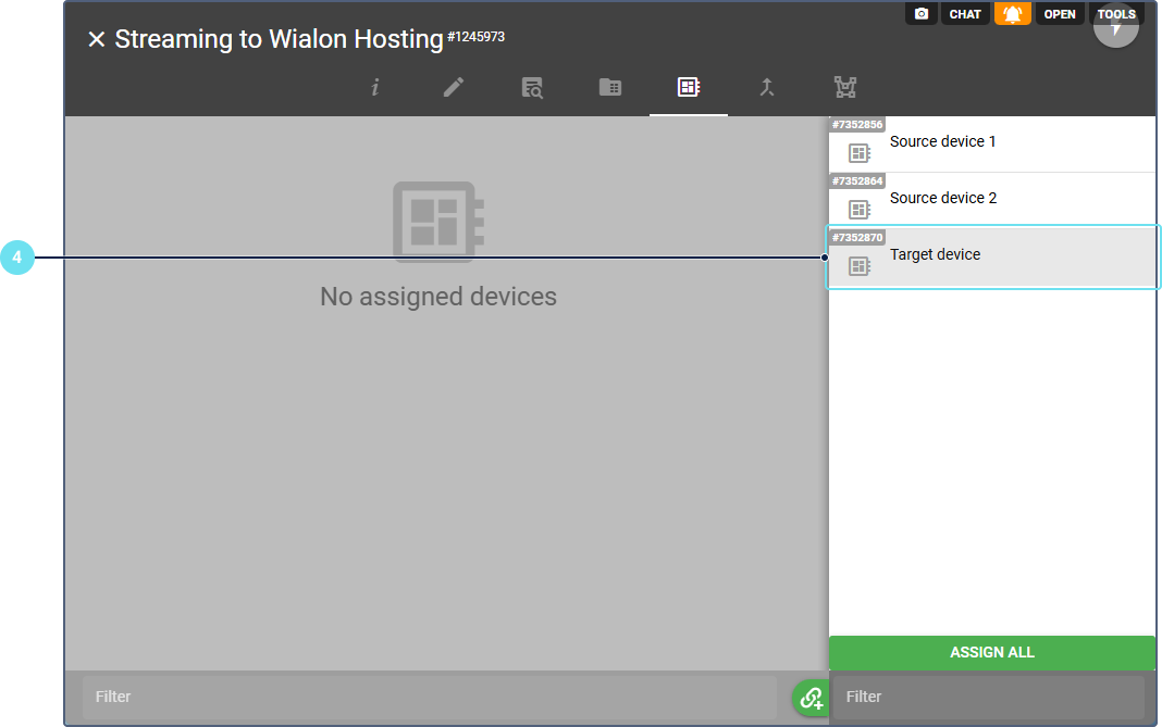

Assigning the target device to the stream
To assign the target device to the stream, follow these steps:
  1. Select the created stream.
  2. Open the Devices tab.
  3. Click the clip button in the lower-right corner.
  4. Select the target device.
