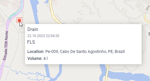

Special markers can be shown on the map in the places of drains.
