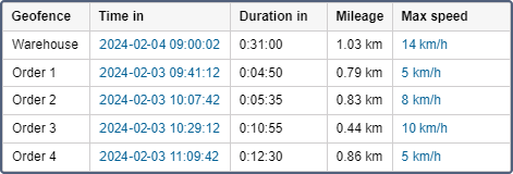

Geofences
To run a report with the Geofences table, you should have the View geofences access right to the resource to which the geofences belong and to the resource in which the report template has been created.
The Geofences table contains information about the geofences visited by a unit. By default, it shows intervals when the unit was inside a geofence. Using the Interval type option in the table settings, you can select whether to show intervals inside a geofence, outside, or both. The interval boundaries are defined by the Geofence exit option in the report template settings. You can also use this table to see the total number of visits per geofence by adding the Visits column and combining it with grouping (for example, by geofence, day, or month).
When adding this table to a report, you must select one or more geofences in the table settings. You can use both the geofences from the resource in which the report template is created and the geofences from other resources to which the user has the View geofences access right. The resource is selected in the dropdown list above the list of geofences. You can also select the All option for the list to contain the geofences from all the resources to which the user has the necessary access right. The geofences in the list are sorted by name. To quickly find one, use the dynamic filter.
The Geofences table can include the columns described below.
Geofence The name of the geofence.

Time in The time when the unit entered the geofence.
If the interval type is Outside geofence, the column shows the time when the unit left the geofence and entered the outside area.
Time out The time when the unit left the geofence.
If the interval type is Outside geofence, the column shows the time when the unit left the area outside the geofence and entered the geofence.
Duration in The duration of the visit.

Mileage The mileage inside the zone.

Max. speed The maximum speed with which the unit moved in the geofence.

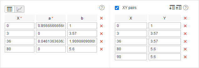

How to determine fuel consumption, if I know how much fuel the unit consumes within the city, and how much outside it?
Let us suppose that the fuel consumption in the urban cycle is 10 l/100 km and 7 l/100 km — in the suburban cycle.
  • Create an ignition sensor (as in the example above) and set 1 l/h for the consumption during idling.
  • The average consumption in the urban cycle is 36 km/h, in the suburban — 80 km/h.
  • The unit will cover a distance of 100 km driving at a speed of 36 km/h in 2.8 hours. 10 l / 2.8 = 3.57. Let us calculate the value of the increasing coefficient when moving in the city: 3.57 / 1 (idling) = 3.57.
  • As a result of a similar calculation for the suburban cycle, we obtain the coefficient equal to 5.6.
  • Create an engine efficiency sensor, taking into account the fact that the unit cannot consume less fuel than during the idling, and that it is stationary before the beginning of the movement. As a parameter we use the average speed (speed + # speed) / const2 and fill in the calculation table (manually or using the calculation table wizard):
Note that the last pair of points is how the system calculated before (the fuel consumption was considered constant for a speed above 80 km/h). You cannot use this method and change the set of points. Also ‘3’ in this example is the minimum speed from the unit’s trip detector, consequently, this parameter can be different for your unit.
Result: in our example, the average consumption has been calculated for the unit. It has been calculated relative to the speed and time between messages and taking into account the values of the vehicle operation.
