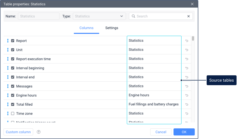

Filtering intervals in source tables
Source tables are the tables that provide data for calculating the value of a statistics row. The name of the source table is shown next to the row name on the Columns tab.
Filtering allows you to select specific table intervals that should be considered for calculating the final value in the statistics row. Intervals depend on the table type. In the Engine hours table, intervals are engine operation periods based on the engine hours sensor, in the Eco driving table — violations, and so on. For example, you can configure the table to show only those engine operation periods during which the vehicle was parked or only those violations that lasted longer than 1 minute.

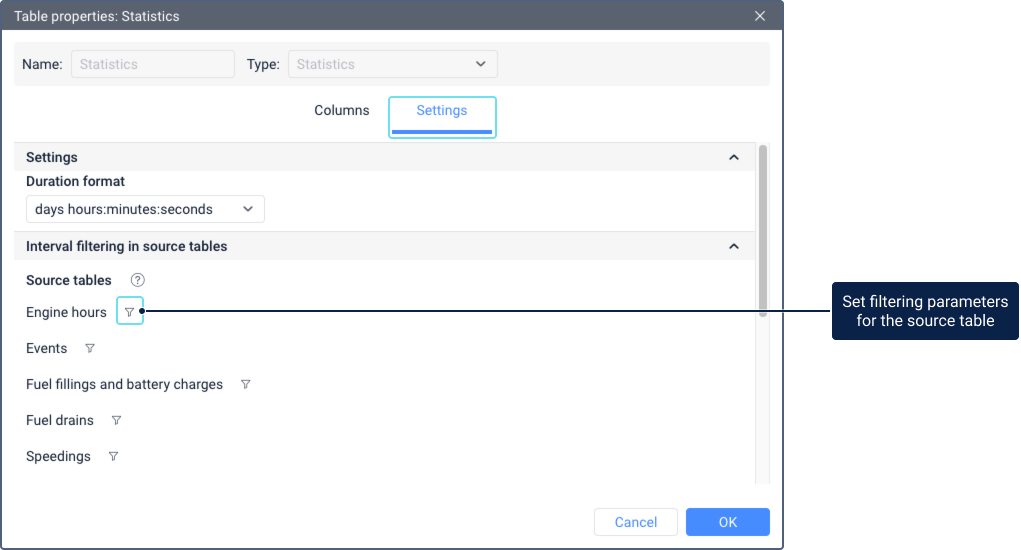

To configure interval filtering in statistics, follow the steps below:
Go to the Settings tab in the properties of the Statistics table.
Click on the icon
next to the name of the source table.

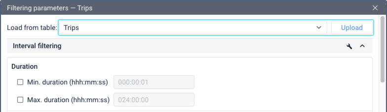

In the Filtering parameters window, configure the conditions for including intervals in the table. See the description of all filters on the Interval filtering page.
If the report template already has a table with filtering configured, you can apply it to the Statistics table. To do this, select this table at the top of the window and click Load.
If necessary, configure the order in which filters should be applied. To do this, click on the icon
in the Interval filtering row and drag the filters in the list using the icon
As a result, the values of statistics rows associated with this table are recalculated according to the configured filtering.
