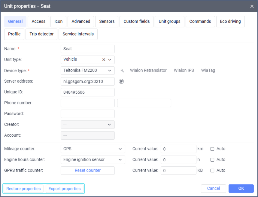

The buttons for restoring and exporting the unit properties are displayed at the bottom of the General tab.

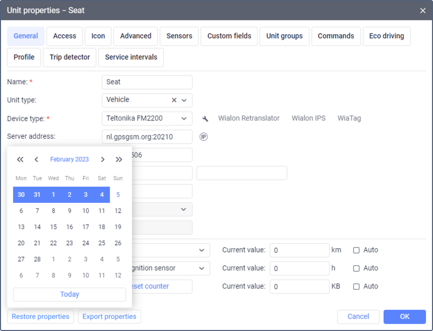

If you change or delete data on a certain tab of the unit properties by mistake, you can restore it. The settings of the properties saved in the last 14 days are available for recovery. These settings are saved automatically on a separate server once every 24 hours.
To restore the version of settings for a certain day, follow these steps:
  1. Click on the Restore properties button.
  2. In the calendar, select a date for which you want to restore the settings. The dates with the available saved settings are highlighted in blue.
  3. In the window that opens, select the properties you want to restore and click OK.
