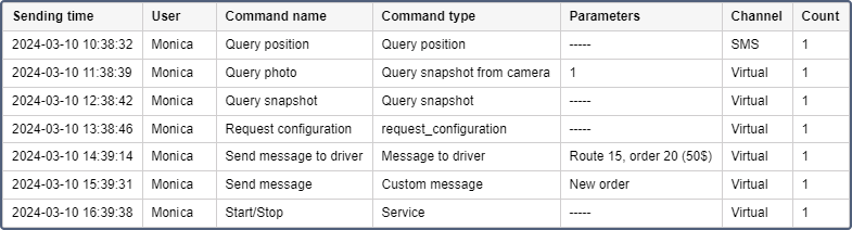

Sent commands
The Sent commands table lists all the commands that were sent to a unit over the interval period.
Below is a description of the columns that the Sent commands table may contain.
| Column | Description |
| Sending time | The time when the command was sent to the unit. |
| User | The name of the user who sent the command (hidden if you do not have access rights to the user). |
| Command name | The name of the command as it is written in the unit properties. |
| Command type | The type of the command (see the list). |
| Parameter | The additional parameter in the command (some commands do not have such parameters). |
| Execution time | The time when the command was executed. |
| Channel | The type of connection used to execute the command (TCP, UDP, Virtual, SMS). |
| Count | The number of sent commands. |
| Notes | An empty column for your custom comments. |
This is the list of successfully executed commands. To view all the commands sent to the unit regardless of their execution, go to the Messages tab.
