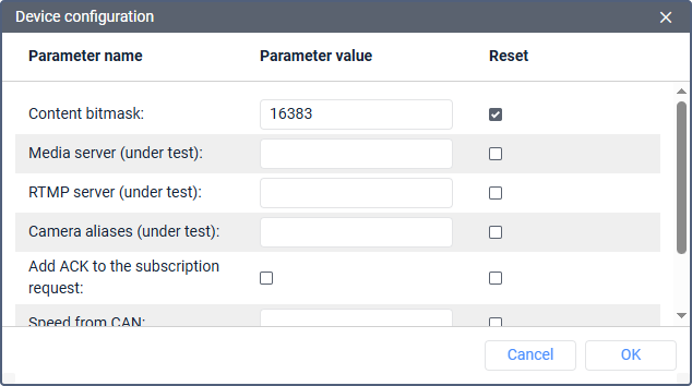

Additional device settings
The additional device settings are available in the unit properties upon clicking on the icon
next to the Device type field.
The available settings are as follows:
| Setting | Description |
| Content bitmask | Here you can specify a bitmask which determines the parameters that should be sent by the device. To send all the available parameters, enter the value 16383. Content bitmask values are described below. |
| Add ACK to the subscription request | This option allows adding the ACK packet which acknowledges receiving a message. Use only if the device has the ACK option activated. |
| Speed from CAN | This option allows replacing speed values by the CAN parameter. |
| 0x4040 Subscription upload model | This option allows setting data upload priority. Use 0 for real time priority, 1 for history priority, 2 for mixed. |
The Media server (under test) , RTMP server (under test) and Camera aliases (under test) fields are deprecated. They should be left blank.
