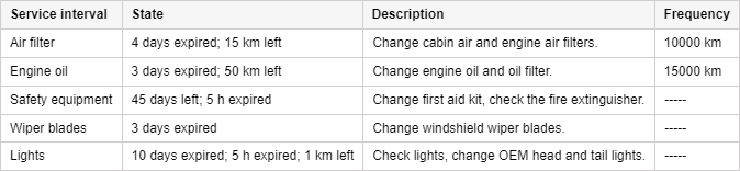

Upcoming maintenance
The Upcoming maintenance table contains the list of service works set for a unit and the status of their execution. The table can include the columns described below.
ColumnDescription
Service intervalThe name of the scheduled maintenance work indicated on the Service intervals tab of the unit properties dialog in the Service name field. The work should be repeated throughout a particular interval indicated on the Service intervals tab.
StateThe overall state of the execution of the service work. In other words, it is the remaining or expired interval of mileage, engine hours, and days.
State by mileageThe remaining or expired mileage interval.
State by engine hoursThe interval of the remaining or expired engine hours.
State by daysThe interval of the remaining or expired days.
DescriptionThe information taken from the corresponding field on the Service intervals tab.
FrequencyThe interval (mileage, engine hours, or days) that shows how often vehicle maintenance should be performed.
