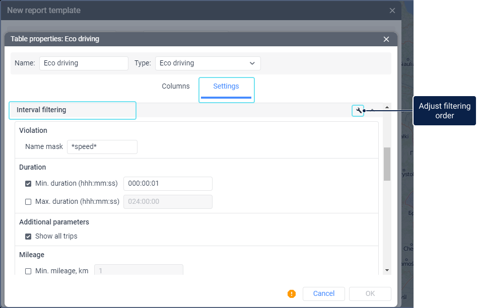

You can see the Interval filtering section on the Settings tab of the table properties. The available filters, that is, the parameters on the basis of which filtering is carried out, depend on the table type.
You can apply several filters simultaneously. To change the order in which the filters are applied, click on the icon and drag the list items above or below.

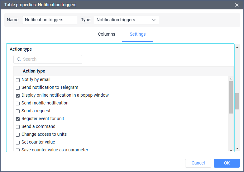

Action type
The filter is available for the Notification triggers table.
If you want to include the triggered notifications only with certain actions in the table, mark the actions in the list. To find the necessary notification action, use the search field above the list.
See also the Notification name, Notification condition and Notification text filters.

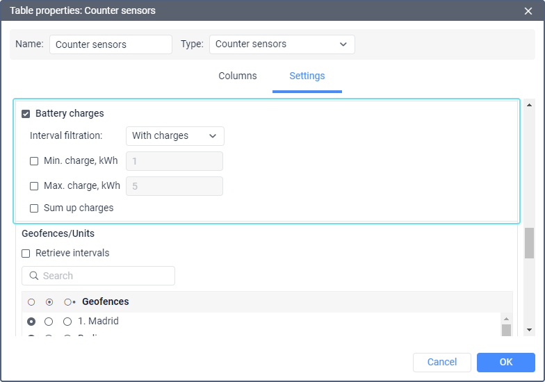

Battery charges
The Battery charges filter is available for the following report tables:
  • Counter sensors
  • Digital sensors
  • Engine hours
  • Fuel fillings and battery charges
  • Geofences
  • Parkings
  • Rides
  • Stops
  • Trips between geofences
  • Unfinished trips
  • Visited streets
The Battery charges filter allows including in the report the intervals within which charges were detected, or intervals without charges. In the Min. charge and Max. charge fields, you can specify the minimum and/or maximum charge volume required to include the interval in the report.
If the Sum up charges option is enabled, the volume of all charges within the interval is summed and compared to the value from the Min. charge and/or Max. charge fields. If the condition is met, the interval is included in the report.
Example. A report on parking intervals is executed. During a parking interval, charges of 1 kWh, 2 kWh and 3 kWh were registered. The Min. charge field is set to 5 kWh. If the Sum up charges option is disabled, such a parking interval is not shown in the report. If the option is enabled, then the parking interval is shown in the report because the total volume of the charges is 6 kWh.

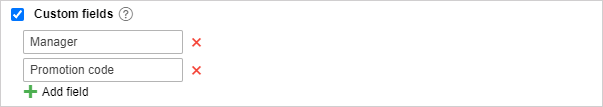

Custom fields
The filter is available in the Orders table and works by custom fields specified in the order properties in the Logistics application. It allows you to specify the names of custom fields which should be shown in the report. If the filter is disabled, the report shows all the custom fields from the orders included in the routes for the selected report interval.

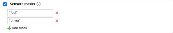

Custom sensor masks
In this filter, you can specify the masks of custom sensors which should be taken into account when running the report. The filter is available in the Digital sensors, Geofences, Fuel filling, Fuel drains, Eco driving tables.

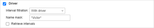

Driver
This filter allows you to include the intervals within which drivers were assigned to the units, or to exclude such intervals from the report.
The following options are available in the filter:
Option Description
With driver The report shows those intervals within which drivers were assigned to the units.
In the Name mask field, you can specify the name mask of the driver whose intervals should be included in the report. The mask also works if several drivers were assigned to the unit simultaneously within a certain interval. To see several drivers in the report, enable the Multiple drivers/trailers option in the template settings.

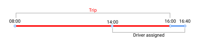

Example. A report on trips is executed. During one of the trips, two drivers were assigned to the unit: John and David. If John is specified in the Name mask field, the report shows only those trips, during which only this driver was assigned. If *John* is specified in the field, the report also shows the trip during which the two drivers were assigned.
The intervals are shown entirely, regardless of when the driver was assigned: at the beginning, end or middle of the interval. If you want to see exactly the part of the interval during which the driver was assigned to the unit, enable the Retrieve intervals option.
Without driver The report shows the intervals during which no driver was assigned to the unit.
Driver group The report displays the intervals during which any driver from the specified group was assigned to the unit. The group name or name mask should be specified in the Name mask field. The principle of extracting intervals is the same as in the case of the With driver option (see the description above).
For the Tasks table, this filter is available without the Retrieve intervals option.

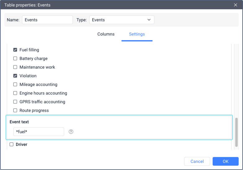

Event text
This filter is available for the Events and Violations tables.
If you want to include in the table only those events whose text contains certain words or values, specify their mask.
See also the Event type filter.

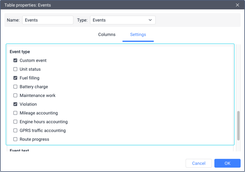

Event type
This filter is available for the Events table.
If you want to include only certain event types in the table, mark them in the list. To find the necessary type, use the search field above the list.
See also the Event text filter.

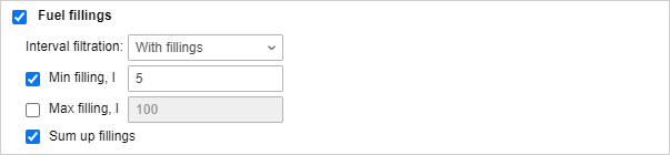

Fuel fillings
This filter allows you to see the intervals within which fuel fillings were detected, or intervals without fillings. In the Min filling and Max filling fields, you can specify the minimum or maximum filling volume which is required for including intervals in the report.
If the Sum up fillings option is enabled, the volumes of all the fillings within the interval are summed up and compared to the value from the Min filling and/or Max filling fields. If the condition is met, the interval is included in the report.
Example. A report on parking intervals is executed. During a parking interval, the system detected fuel fillings of 1 l, 2 l, and 3 l. In the Min filling field, a value of 5 litres is specified. If the Sum up fillings option is disabled, such a parking interval is not shown in the report. If the option is enabled, the parking interval is displayed in the report because the total volume of the fillings is 6 litres.

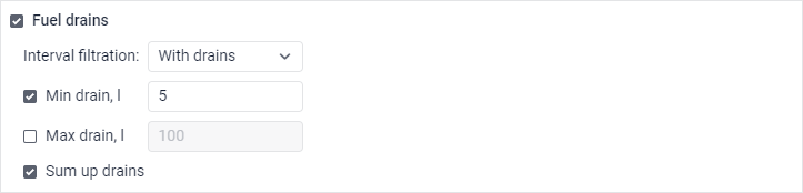

Fuel drains
The filter allows you to see the intervals within which fuel drains were detected or intervals with no fuel drains.
If the With drains option is selected, then you can specify the minimum and/or maximum amount of fuel drained at one time in the Min drain and Max drain fields in order for the interval to be included in the report. If the Sum up drains option is activated, then the sum of all drains within the interval should meet the conditions from the fields.
Example. A report on trips is executed. A value of 5 l is specified in the Min drain field. During the trip, drains of 2 l, 3 l and 4 l were detected. If the Sum up drains option is disabled, the trip is not shown in the report. If it is enabled, the trip is shown because the total volume of drains is 9 liters.

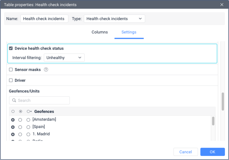

Health check status
This filter is available for the Health check incidents table.
It allows filtering the incident intervals depending on the unit device status at the beginning of the incident interval. For details about device statuses, see the Dashboard page.
Option Description
All The table shows all incident intervals.
Need attention The table shows only those incident intervals at the beginning of which the unit device status was Need attention.
Unhealthy The table shows only those incident intervals at the beginning of which the unit device status was Unhealthy.

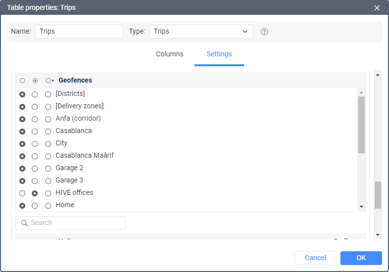

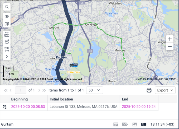

Geofences/Units
The filter allows you to see those intervals within which the unit was inside or outside of the selected geofence or area around the selected unit. Only geofences that belong to the same resource as the report template itself can be displayed here.
By default, the intervals are shown entirely. To see only those parts of the interval during which the unit was inside or outside of the geofence/unit area, enable the Retrieve intervals option.
The filter section consists of two lists: the list of geofences and the list of units. Above each list, there is a dynamic search by item name.
List of geofences
For each list item, you can specify one of three statuses:
  • : The item (geofence or unit area) is not taken into account.
  • : Intervals inside this geofence or unit area. The report table includes those intervals where the unit sent at least one message inside the selected geofence (or unit area). Example. In the image below, the Trips table is filtered by the Inside “Railroad” geofence criterion. It includes a trip during which the vehicle sent messages within this geofence, though only briefly.
  • : Intervals outside this geofence or unit area. The report table includes those intervals where the unit sent all messages outside the selected geofence (or unit area).

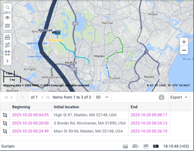

    Example. In the image below, the Trips table is filtered by the Outside the “Railroad” geofence criterion. It includes three trips which had no message inside this geofence.

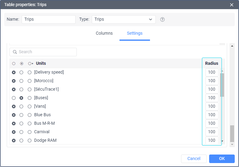

For units, you can specify the radius of the area around them, that is, how close the unit on which the report is executed should be to these units in order for the interval to be included in the report.
List of units
To select all the items in the list, hold Ctrl while selecting them. If a group is marked, then all the geofences or units from the group are considered selected. In this case, an interval is shown in the report if any of these geofences and/or unit areas were visited during it.

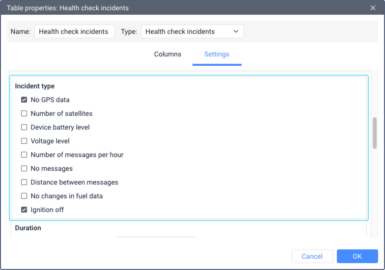

Incident type
The type of incident depends on the criteria set in the unit properties. For details, see the Health check page.
If you want to include only certain incident types in the table, mark them in the list.

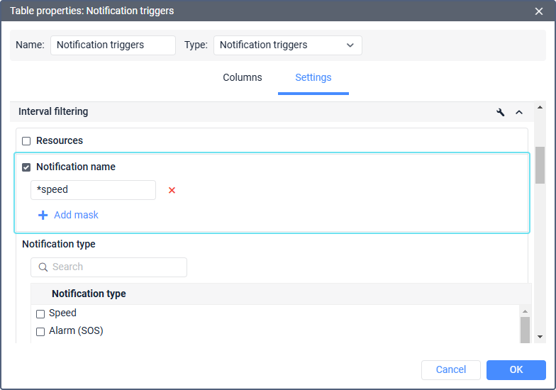

Notification name
Here you can specify masks for the names of triggered notifications.
See also the Action type, Notification text and Notification condition filters.

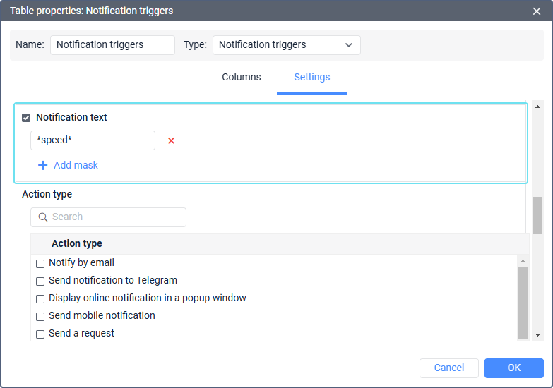

Notification text
If you want the table to include only those triggered notifications that contain certain words or values in the notification text, specify their mask.
See also the Action type, Notification name and Notification condition filters.

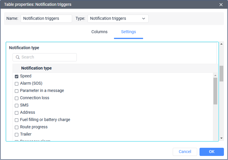

If you want to include only certain triggered notification conditions in the table, mark them in the list. To find the necessary type, use the search field above the list.
See also the Action type, Notification name and Notification text filters.

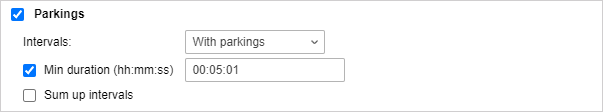

Parkings
The filter allows you to see only those intervals within which parking periods were detected (With parkings option), or only those intervals within which there were no parking periods (Without parkings option). Parking periods are detected according to the settings in the trip detector. See the detailed description here.
If the With parkings option is selected, you can specify the minimum parking duration in the Min duration field in order for the interval to be included in the report. If the Sum up intervals option is enabled, the duration of all the parking periods within the interval is summed up and compared with the specified minimum duration.
Example. A report on geofence visits is executed. You want the report to show only the visits during which the unit was parked. A value of 10 min. is specified in the Min duration field. The unit had been parked inside the geofence for 5 and for 7 minutes. If the Sum up intervals option is disabled, the geofence visit won’t be included in the report. If the option is enabled, the visit will be shown in the report because the total parking duration was 12 minutes and the minimum duration requirement was met.

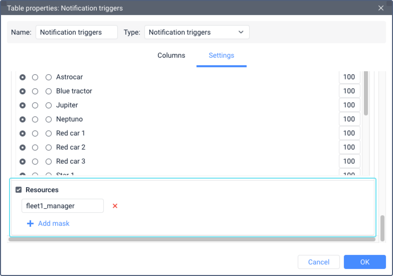

Resources
The Resources filter is available for the Notification triggers table.
Here you can specify names or name masks of resources. If a resource is specified, the table shows only triggers of those notifications which belong to the specified resource.

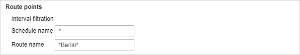

Route points
This filter is available in the Check points table. Here in the Schedule name and Route name fields, you can specify masks for schedules and/or routes, respectively. In this case, the report will only show the check points related to the specified schedules and/or routes.

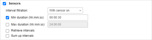

Sensors
This filter allows you to see the intervals within which a sensor of the Digital group was on or off.
The following options are available for the filter:
Option Description
With sensor on The report shows the intervals within which the sensor was on. By default, the intervals in the report are displayed entirely. To see only those parts of the interval during which the sensor was on, activate the Retrieve intervals option.
In the Sensor masks filter, you can specify the name of a sensor or a mask for several sensors. If several sensors are specified, the report shows the intervals within which all of them were on at the same time. If no sensor is specified, all the unit sensors are taken into account in the report.
With sensor off The report shows the intervals within which the sensor was off. For this option, you can also retrieve intervals and specify a sensor mask (see the description above).
Min duration The minimum time during which the sensor should be on or off in order for the interval to be shown in the report.
Max duration The maximum time within which the sensor should be on or off in order for the interval to be shown in the report. This option is used if you don’t want the report to take into account the sensors that are on for a long time.
Retrieve intervals If the option is disabled, the intervals in the report are shown entirely when they match the filter conditions. If the option is enabled, then the report shows only those parts of the interval during which the sensor was on or off. Each such part occupies a separate line.
Sum up intervals This option can only be used if the Min duration and/or Max duration fields are filled in. If it is enabled, then all the periods during which the sensor was on or off within the report interval are summed up and the result is compared with the specified duration value. If the amount matches the condition, the interval is shown in the report.
Example. A report on trips with the sensor on is executed. A value of 60 seconds is indicated in the Min duration field. The Sum up intervals option is activated. During the trip, the sensor was on for 20 seconds, for 30 seconds and for 15 seconds, that is, for a total of 65 seconds. This value meets the minimum duration condition, therefore, the trip is shown in the report.
Sensor masks
Here you can specify the masks of the sensors which should be taken into account when executing the report. The specified masks influence:
  • Sensors filter;
  • values in the Counter, Initial counter, Final counter columns;
  • values in the columns related to engine revolutions, temperature and fuel;
  • custom sensor values if the Custom sensor masks filter is not used.
The mask of the engine hours sensor is specified separately in the Engine hours sensor filter.

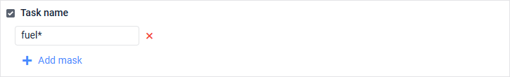

Task name
This filter is available for the Tasks table.
Here you can specify a task name mask so that the table displays only the tasks with the names that match this mask.
See also the Task text and Task type filters.

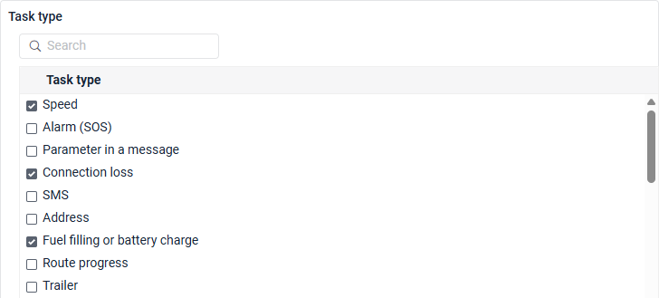

Task type
If you want to include only certain task types in the table, select them in the list. To find the necessary type, use the search field above the list. The list of available types matches the notification conditions.
See also the Task name and Task text filters.

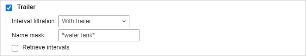

Trailer
The filter allows you to see the intervals within which a trailer or no trailers were assigned to the unit. The options in this filter work in the same way as the options in the Driver filter.

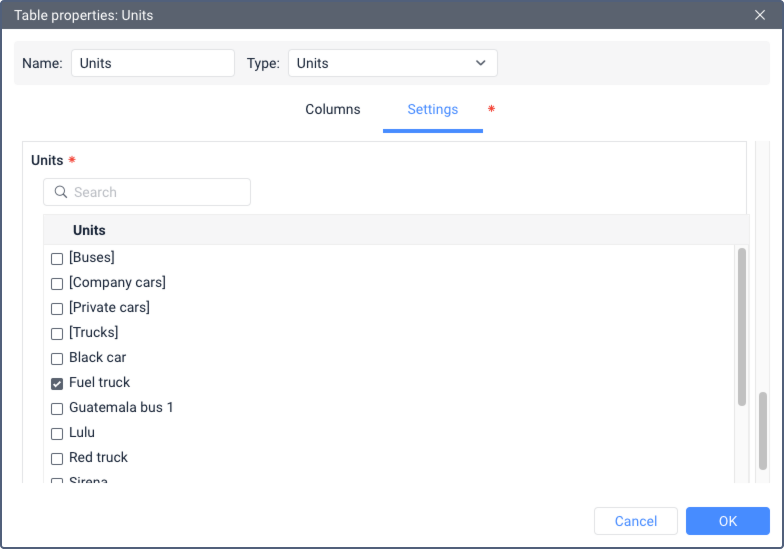

Units
The Units filter is available in the following tables:
Report type Table
Passengers, Groups of passengers Assignments
Trailer, Group of trailers Assignments
Geofence, Group of geofences Units
In the Assignments table, the filter is used to show the assignments of passengers or trailers only to specific units.
The Units table requires selecting units in the filter.
You can select units and unit groups in the filter list.

Violation
The filter is available in the Eco driving table. Here you can specify the name mask of violations which should be taken into account when executing the report.

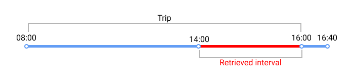

“Retrieve intervals” option
The Retrieve intervals option is available for some filters. It allows to show in the report table only those segments that match the additional criteria specified in the interval filter.
Example 1. The With driver filter is used in a trip report. The trip lasted from 08:00 to 16:00. The driver was assigned to the unit at 14:00 and separated from it at 16:40. If the Retrieve intervals option is disabled, the report shows the entire trip from 08:00 to 16:00.
If the option is enabled, only the part of the trip from 14:00 to 16:00 is shown.

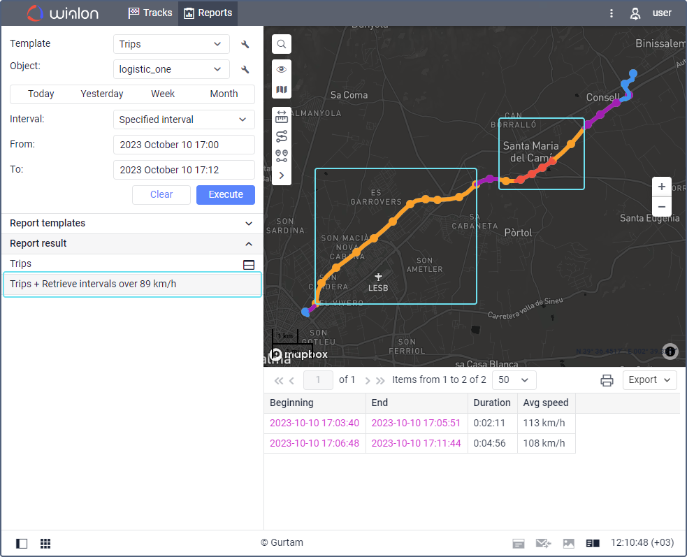

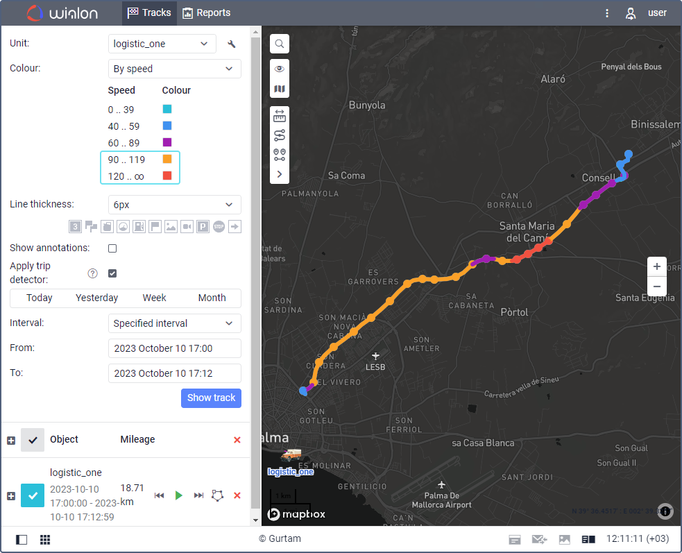

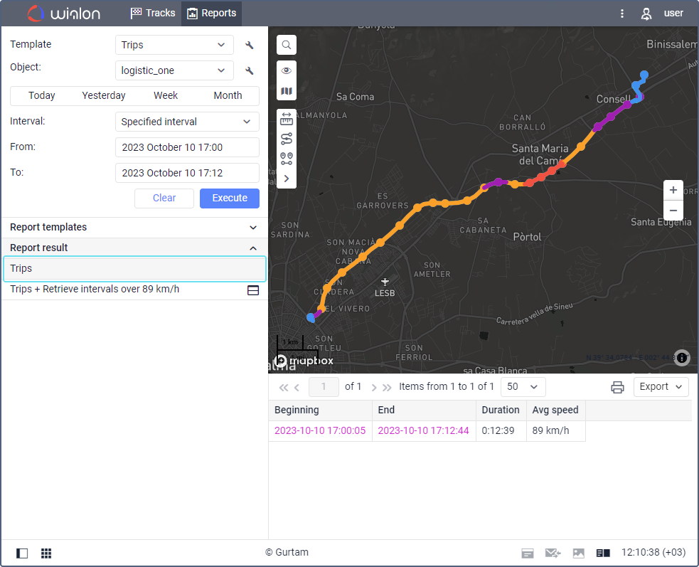

Example 2. A report on trips is being executed. It is known that the unit travelled at speeds above 90 km/h during the indicated period of time. On the unit track the speed above 90 km/h is marked in orange color, and above 120 km/h is marked in red color. The user needs to show in the report only the segments where the unit travelled at a speed of 89 km/h and above (Image 1).
To do this, in the Speed filter, specify a minimum value of 89 km/h. If you execute the report with these settings, it will show the entire interval where the speed was higher than 89 km/h (Image 2).
To show in the report only those segments where the speed was higher than 89 km/h, you need to enable the Retrieve intervals option in the Speed filter.
This will exclude the segments marked on the track with purple and blue color (Image 3).
