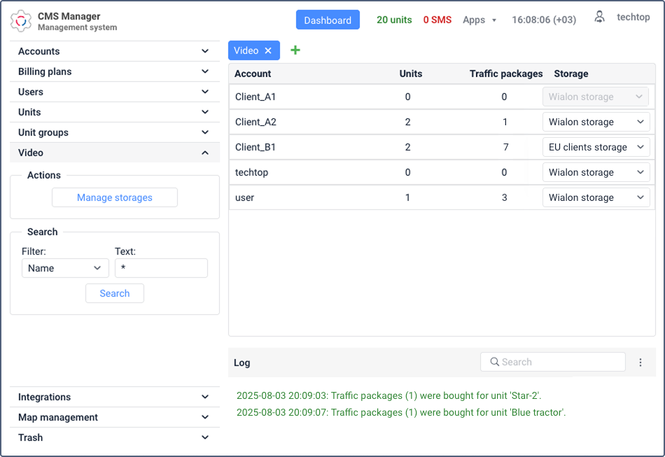

Account table
After opening the Video section, you can see a list of subordinate accounts in the properties of which the Video monitoring service is enabled. This list is displayed as a table with the following columns:
Column Description
Account The name of a subordinate account.
Units The number of units in a subordinate account that have been added for video monitoring.
Traffic packages The total number of traffic packages purchased for all the units of the account from the moment they were added.
Storage Allows you to assign a specific storage solution (the default Wialon storage or a configured custom storage) to the entire account. Video files of account units will be saved in the selected storage.
Click on the row with the account name to add units for billing, see information on traffic for the added units or buy traffic packages for them.

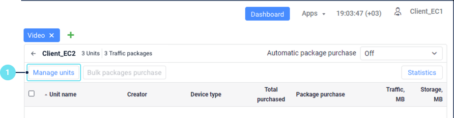

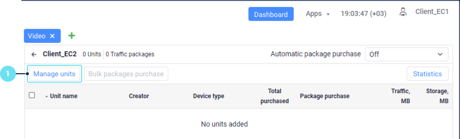

In order for video monitoring features to be available for the units of an account, add these units for billing. To do this, follow the steps below.
  1. Click Manage units.
  2. In the list of available units, select the ones you want to add for billing. The list contains only the units the devices of which support video monitoring features. To select several successive items at once, mark the first one and, while holding down the Shift key, mark the last one. Use the Select all option to select or clear the selection of all the items at the same time. The dynamic filter above the unit list works by name, device type, or creator. The search criterion is selected to the right of the filter.
  3. Move the selected units to the list of the billed ones by clicking on the icon .
  4. Click Apply.
After adding a unit to the list, a traffic package (1024 MB) is purchased for it automatically. The video of this unit becomes available for watching on the Video tab of the monitoring system.
The list of the added units is displayed as a table. A traffic package is purchased automatically for each unit every month. Subsequently, you can purchase traffic packages in different ways.
A record of activating billing and video monitoring features is shown in the log.

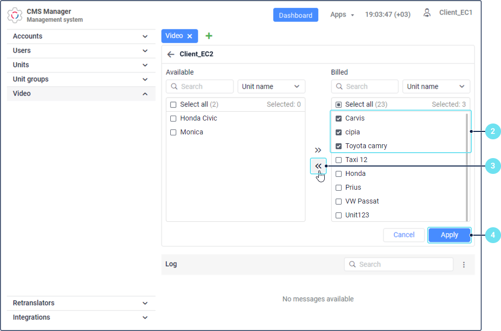

Disabling video for units
To deactivate billing and video monitoring features for a unit, remove it from the list following the next steps:
  2. In the list of billed units on the right, select the ones for which you want to disable the video monitoring. You can select and search for units in the same way as when you add units.
  3. Move the selected units to the list on the left by clicking on the icon  .
  4. Click Apply.
The information about the purchased and used traffic packages is stored until the end of the current month. Thus, if you remove a unit with available traffic, you can move it back to the billing list until the end of the current month and use this traffic. If you move the unit back after this period, you will lose the remaining traffic and a new package will be purchased automatically.
A record of deactivating billing and video monitoring features is shown in the log.

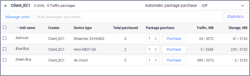

Unit table
The table displays only the units added for billing. The upper row shows the name of the selected account, the number of added units, and the total number of traffic packages purchased over the current month.
You can sort data in the table by the Unit name column in direct or reverse order.
The following buttons are displayed above the table:
Button Function
Manage units Adding or removing the account units from the billing list. This function is described above.
Bulk package purchase Purchasing traffic packages for several units at the same time. This function is described here.
Automatic package purchase Configuring the automatic purchase of traffic packages.
Statistics Viewing the charts of traffic usage by month and by unit.
The table contains the following columns:
Column Description
Unit name The name of the unit added for billing.
Creator The creator of the unit.
Device type The device type of the unit.
Total purchased The number of traffic packages purchased for the unit.
On the first day of each month, the value in this column is reset: the remaining traffic is not accumulated and a new package (1024 MB) is purchased automatically.
Package purchase A column designed for purchasing traffic packages for each unit separately. This feature is described here.
Traffic, MB The amount of used (before the slash) and purchased traffic (after the slash).
If 100 MB or less is left until the purchased traffic ends, the unit row is coloured red and a system notification is received.
The information about traffic usage is also available on the Video tab of the monitoring system. See details on the Live stream page.
Storage, MB The total size of the saved video files of the unit (before the slash) and their limit (after the slash).
The storage limit depends on the storage solution assigned to the unit account:
  • Wialon storage (default): The limit is 5 GB.
  • Custom storage: The limit is the value configured in the Limit per unit field for that specific storage.
If 100 MB or less is left until the limit is reached, the unit row is coloured red and a system notification is received. If the limit is reached, the older files are automatically deleted as soon as the new ones are saved. Read about the particularities of storing files here.
To return from the unit table to the list of accounts, click on the icon .
