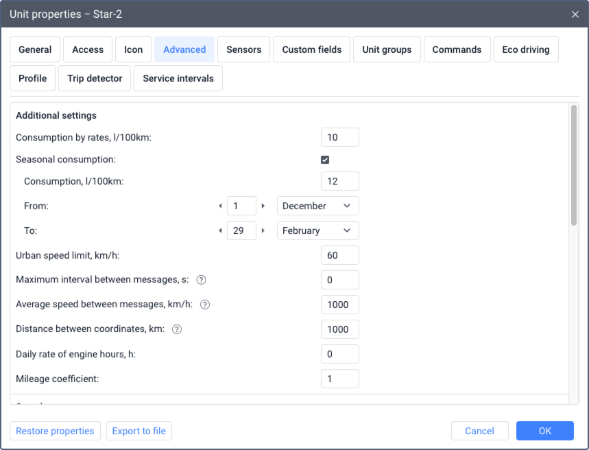

Additional settings
The parameters available in this section influence the calculations of fuel consumption, mileage, engine hours and other data.
Parameter Description
Consumption by rates Fuel consumption per 100 kilometers. Another unit of measurement can be used, depending on the selected measurement system. The default value is 0.
Seasonal consumption The option which allows you to specify a separate fuel consumption rate for a certain period. The default value is 0.
Urban speed limit The maximum speed at which it is conventionally considered that the unit is moving within the city. Moving at a higher speed is considered as suburban mileage. You can use this setting in reports: in the Trips table, in statistics, in the advanced report on drivers.
Maximum interval between messages The maximum interval between messages in seconds.
If the time difference between two messages exceeds the specified value, such a time interval is considered a connection loss. You can view the intervals of no connection in the Connection problems report.
The option can affect:
  • the calculation of fuel consumption by maths and FLS;
  • the determination of engine hour, fuel filling and drain intervals;
  • the display of tracks and charts: the lines are interrupted where the specified value has been exceeded.
The default value is 0 (option disabled).
Average speed between messages This option is used to exclude coordinate outliers when calculating mileage.
Maximum average speed of the unit determined by two successive messages, in km/h. If the specified value is exceeded, these messages are not taken into account when calculating the mileage in reports, in the GPS and GPS + engine ignition sensor mileage counter and on the Messages tab.
To disable the option, specify 0.
Distance between coordinates This option is used to exclude coordinate outliers when calculating mileage.
Maximum distance between coordinates in two successive messages, in km. If the specified value is exceeded, these messages are not taken into account when calculating the mileage in reports, in the GPS and GPS + engine ignition sensor mileage counter and in the Messages tab.
Daily rate of engine hours The daily rate of engine hours (in hours). This value can be used in the report on engine hours (when calculating utilization and useful utilization). The operation of engine hours is determined by the engine hours counter.
Mileage coefficient The coefficient used to correct the mileage calculated in Wialon in cases where it always differs from the actual mileage by a certain number of times.
Example. The mileage calculated in Wialon is 100 km, and the actual mileage (determined by the vehicle equipment) is 120 km. The mileage coefficient that should be specified in this field is 120/100 = 1.2.
The result of multiplication by the coefficient is shown in the Mileage (adjusted) column in different report tables and statistics.

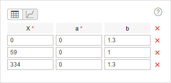

How is the seasonal coefficient calculated?
As a rule, the seasonal coefficient supposes increased fuel consumption. For instance, the consumption in winter is 30% higher than in summer. Let us suppose, that the winter in your climate is from December, 1 to March, 1.

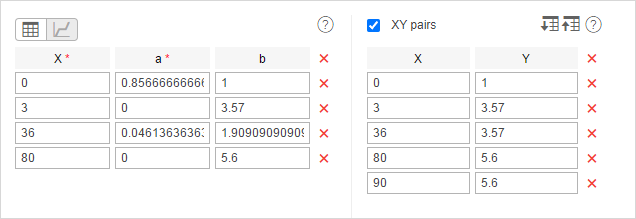

  1. Create an engine efficiency sensor with the parameter time:d.
  2. Find out which numbers of the day in the year do your dates correspond to. High precision is not obligatory: a year may be a leap one and the season itself may be longer or shorter. For the period indicated above, for example, the numbers are ‘334’ and ‘59’ approximately.
  3. Create a calculation table as seen in the screenshot below.
time is the parameter that is present in any message from any device, and the system will calculate the number of the day automatically on its basis. In that way, as the season starts, 30% will automatically be added to the fuel consumption.

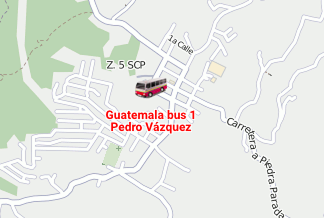

Unit caption color
On the map, each unit can be identified by a label that shows its name and the name of the assigned driver. To display these labels, enable the Unit name and Driver’s name options in the map visible layer settings.
Customizing unit caption color
By default, the names of the units and the drivers assigned to them are shown on the map in gray. To change this color for a unit, use the Unit caption color option. You can choose from a predefined palette or use the color picker for a custom shade.
The selected color can be applied either to the caption text or to its background. Each user chooses the required mode with the Use unit caption color for setting on the map.
For details on displaying other object names on the map, see Drivers on the map, Trailers on the map, and Passengers on the map.

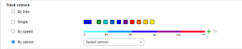

Track colors
In this section, you can set the color for tracks, that is, the lines of unit movement on the map. The tracks are mapped on the Tracks, Messages, Reports, and Monitoring tabs (the Quick track option).
Tracks can be single- or multi-colored depending on the settings according to which the color is determined. You can select one of the four options:
  • by trips
  • single
  • by speed
  • by sensor
Item Description
By trips The track is divided into sections of different colors, each of which corresponds to one trip. Trips are detected by the trip detector.
Single This option applies a single color to the entire track. It is recommended when displaying tracks for a unit group, as it ensures that each unit track is visually distinct and easy to follow. You can select a color from the palette or specify a custom one with the color picker.
When you generate multiple tracks in a row, the system automatically applies the next color from the palette to each new track.
By speed The track is multi-colored depending on the unit speed. To add an interval, click on the icon , specify the speed values and the color for the interval, and click OK. An empty value in the first field is considered as -∞, in the second as + ∞. You can select the color from the palette or specify it in the HEX format in the field above.
The created intervals are shown on the line scale. To edit an interval, click on it, make changes, and click OK.
To reset the settings to the default ones, click on the icon to the right of the scale.
By sensor The track is multi-colored depending on the values of the selected sensor. The list contains the sensors created for the unit. The value intervals and colors for tracks are specified in the sensor properties.

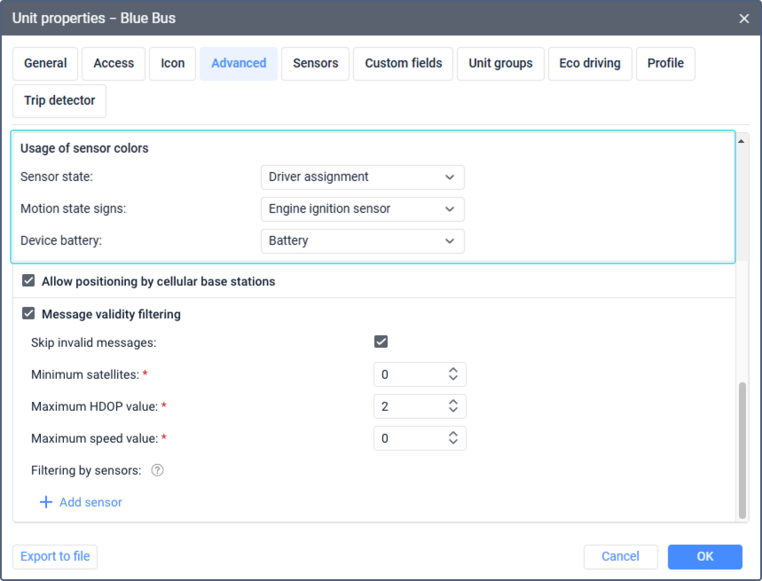

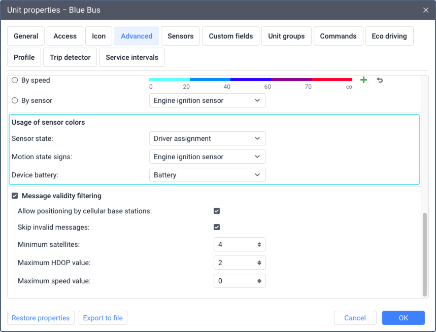

Usage of sensor colors
In this section, you can select the sensors the colors of which should be used for certain interface elements. A sensor is available for selection after you create it and specify its value intervals  and the colors corresponding to them.
Below are the interface elements for which the colors of the selected sensors are used.
Item Description
Sensor state The colors of the selected sensor are used for the Sensor state option in the work list on the Monitoring tab and in the menu of monitoring options on the map.
Motion state signs The colors of the selected sensor are used for motion state signs on the map.
Device battery The colors of the selected sensor are used for the Device battery option in the work list on the Monitoring tab and in the menu of monitoring options on the map.
Also, the sensor selected here is used on the Health check tab for the Device battery level criterion.
If the unit doesn’t have suitable sensors, these options are inactive.

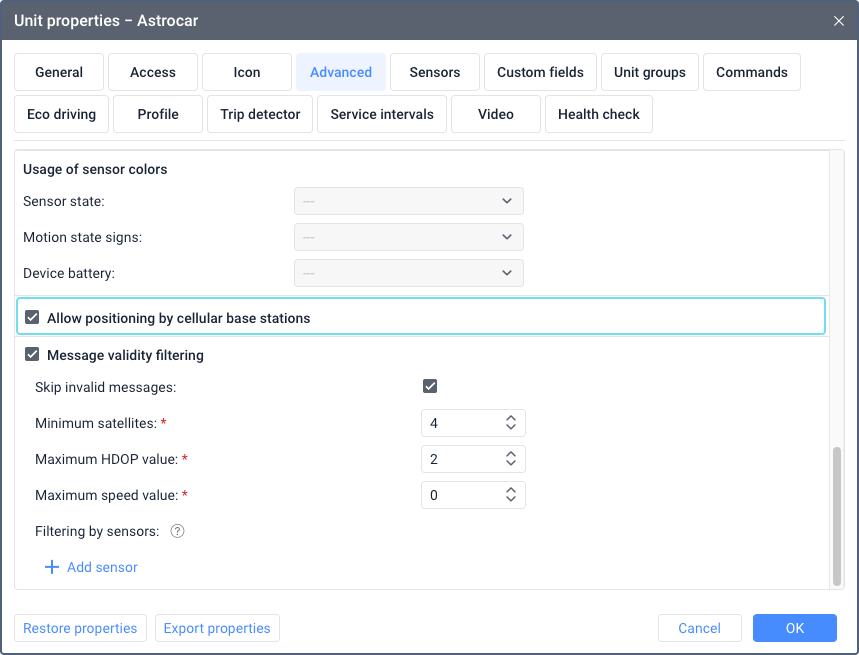

Allow positioning by cellular base stations
This option works for devices which support positioning by cellular stations. To see a list of such devices, select the required section on the Hardware tab and apply the LBS filter. The option allows using cellular base stations (LBS) to determine the unit location, for example, when GPS data is not valid. The data obtained this way is not as accurate as GPS data and shows only an approximate location.
LBS data is used in the following cases:
  • when the Allow positioning by cellular base stations option is enabled and there are no messages with GPS data for more than five minutes;
  • when the Allow positioning by cellular base stations option is enabled and the messages with GPS data received over the last five minutes don’t meet the specified filtering criteria.
During these five minutes, the system shows the unit location and motion state determined by the last valid GPS data. The LBS messages received in the meantime don’t affect the displayed unit location and motion state, but you can see these messages in reports and in the table of messages.
After five minutes, if the values of all LBS parameters (mnc, mcc, lac, cell_id) remain the same as in the last message with valid GPS coordinates, these coordinates continue to be regarded as the last known unit location and the motion state icon doesn’t change. As soon as new values of the LBS parameters are received, a new unit location is shown according to them, and the motion state icon changes to .
If the unit location is determined by LBS, the speed values are not taken into account in the system. In this case, the unit tooltip, the extended unit information and the Speed column in messages show 0.
Messages with LBS data are not taken into account in the trip detector and eco driving.

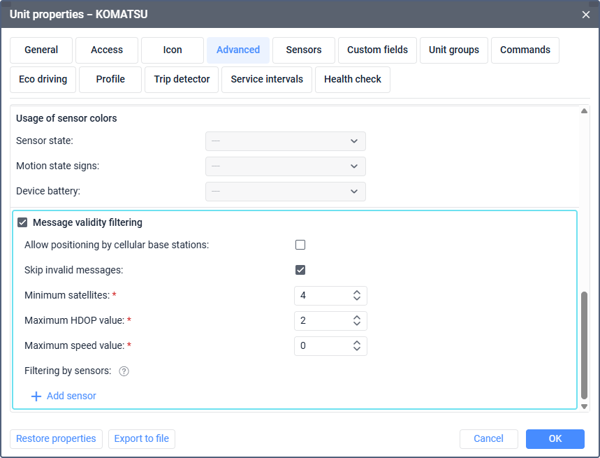

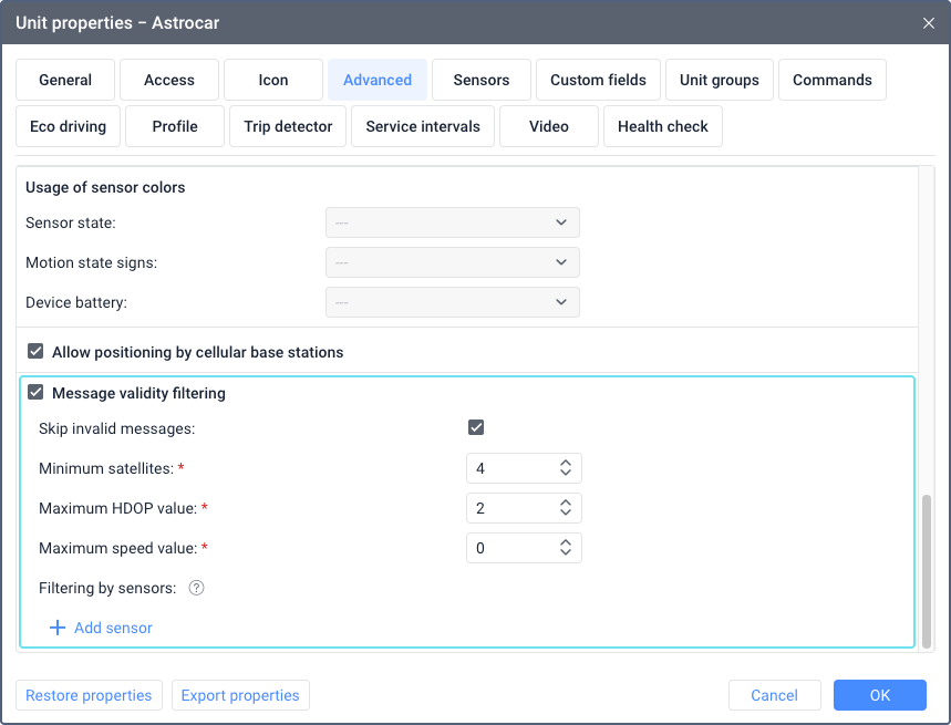

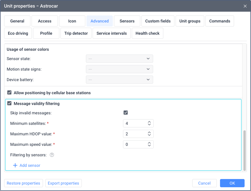

Message validity filtering
All messages from units are registered in the database. However, some messages may be invalid, for example, due to data outliers or lack of coordinates. Such messages distort mileage values, tracks, indicators in reports, and so on.
To solve this problem, Wialon provides message validity filtering. This feature allows you to specify the criteria that determine whether a message is valid or not. If a message is invalid, it is saved in the database without the information received from GPS: that is, without speed, coordinates, number of satellites, altitude, and movement direction. The other data from such a message (for example, sensor values) is saved and can be used in the system.
In addition to the validity criteria, this section provides an option for skipping messages which are invalid according to the unit device. See the description of this option below.
The settings specified here apply only to new messages received after you save the changes.
Regardless of the settings in this section, any message without coordinates or at least one zero coordinate (longitude or latitude) is considered invalid.
Skip invalid messages
The option allows ignoring the GPS data identified by the device as invalid. Some devices (controllers) send special parameters which identify invalid coordinates. Also, the current time and the last valid coordinates are specified in the message. The system considers such a message to be without positional data and doesn’t use it for mapping tracks, determining the location, and so on.
Message validity criteria
The validity criteria follow the OR logic: a message is considered invalid if it fails to meet at least one of the following criteria.
Criterion Description
Minimum satellites In this field, you can specify the minimum number of satellites that should be used to determine the coordinates in order for the message to be considered valid. The recommended number is at least four. The value can’t exceed 255.
Maximum HDOP value In this field, you can specify the maximum HDOP value with which messages are considered valid. HDOP stands for horizontal dilution of precision. The smaller this value is, the more accurate the coordinates are. The value can’t exceed 9,999.
Maximum speed value In this field, you can specify the limit for speed values. If it is exceeded, the message is considered invalid. You can’t indicate a value greater than 9,999. If 0 is specified, this filtering criterion is not taken into account.

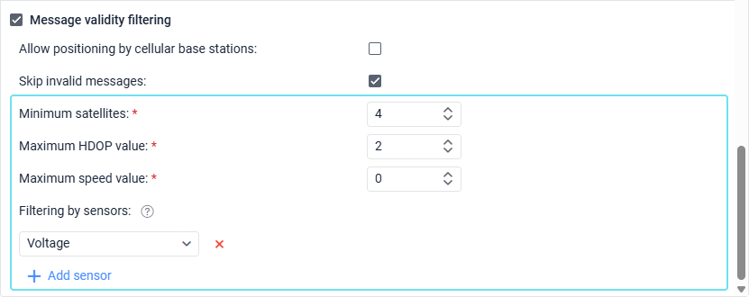

Filtering by sensors Here you can add sensors which should be used to filter messages. If the value of the selected sensor is 0, the message is considered invalid.
To add a sensor, click Add sensor and select the necessary one from the list. You can add several sensors.
