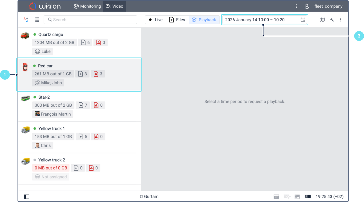

Requesting a playback
To request a playback, follow the steps below.
  1. Select the unit from which you want to request the playback. The list shows units for which cameras are configured. The number of cameras is specified opposite the unit name.
  2. Specify the date and the time period for which you want to request the playback. You can do this manually or using the calendar. In the calendar, the days on which fuel fillings and drains were detected are marked with the icon. The tooltip of the icon shows the first four events of the day and the time at which they were detected. If there were more than four, you can also the number of other fillings and drains.
    When specifying the period, consider the following:
    • You can specify a present or a past date. By default, the current date is selected.
    • The end time should not be earlier than the start time.
    • If the current date is specified, and the end time has not come yet, the playback is requested up to now.
  3. Click Request.

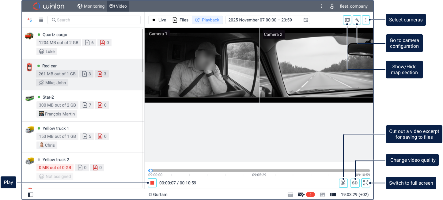

Watching a playback
The requested playback is displayed in the right part of the window. To watch it, click on the play icon or move the slider on the timeline.
The timeline can be completely white or grey, or it can consist of white and grey segments. White means that no data is available for the time period, and grey means that a playback is available from at least one of the selected cameras.
On the timeline, you can see the fuel fillings and drains detected within this period. They are indicated with the markers  and , respectively. The tooltip of the marker shows the name of the event and the time at which it was detected. Click on the marker to watch the playback starting 10 seconds before the event.
When watching playbacks, the following functions are available:
Icon Function
Play video.
Pause video.
/ Enable or disable high video quality. This feature is available only for Howen and flespi gateway devices.
If the device doesn’t support quality change, this icon is not clickable ().
Switch to full screen. You can open all playbacks at once, or each one separately. To do this, click on this icon in the lower-right corner of the tab or playback section, respectively. The icon is shown in the section when you point to it.
Exit the full-screen mode. You can use the Esc key instead.
/ Switch the sound on or off. The icon is displayed when you point to a section of an individual playback. You can play the sound from only one playback at a time. If a playback is open in full screen mode, you can play the audio of only this playback.
If the icon is displayed after you start playing the playback, its sound is unavailable.
Show/Hide a section with a map which shows the unit moving along its track at the time the video was recorded. For more details, see the Unit track on the map when watching playback below.
Open the list of the configured unit cameras. If you want to hide the playback of a certain camera, cancel its selection. Select the camera again to make its playback appear on the screen.
Cut out a video excerpt for saving it to files.
To avoid unnecessary traffic consumption, the system checks whether you’re still watching the video: if the playback plays for 5 minutes in a row, you’re asked whether you’re still watching. If you don’t select any option within 60 seconds, the playback stops. For more details, see the Watching confirmation section.

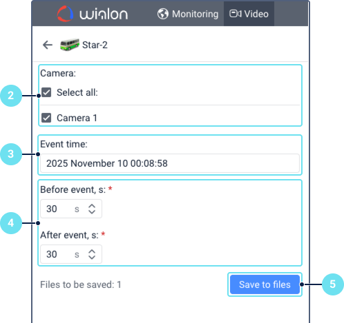

Method 2

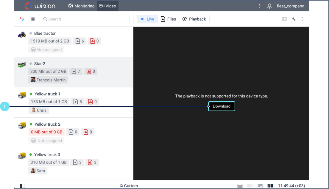

To save a playback excerpt in the second way, select the necessary unit and follow these steps:
  1. Click on the Download button (it is shown on the right side of the screen when you select a unit whose device doesn’t support playback request).
  2. Select one or more cameras from which you want to save the video file. Use the Select all option to select or cancel the selection of all cameras at the same time.
  3. In the Event time field, enter the date and time of the event (to the nearest second) from the excerpt you want to save.  You can do this manually or using the calendar. In the calendar, the days on which fuel fillings and drains were detected are marked with an icon. The tooltip of the icon shows the first four events of the day and the time at which they were detected. If there were more than four, you can also the number of other fillings and drains.
  4. Specify the duration before and after the event in seconds. The minimum allowed value for each field is 1. You can set different values for the periods before and after the event, as long as their total doesn’t exceed the limit. The duration of the file you want to save is equal to the sum of the specified values.
  5. Click Save to files.
The requested excerpt is saved only if the playback for the specified period is available on at least one of the selected cameras.
You can monitor the loading progress on the Files tab. The saved file is later available on the Files tab, in messages, and in reports.
