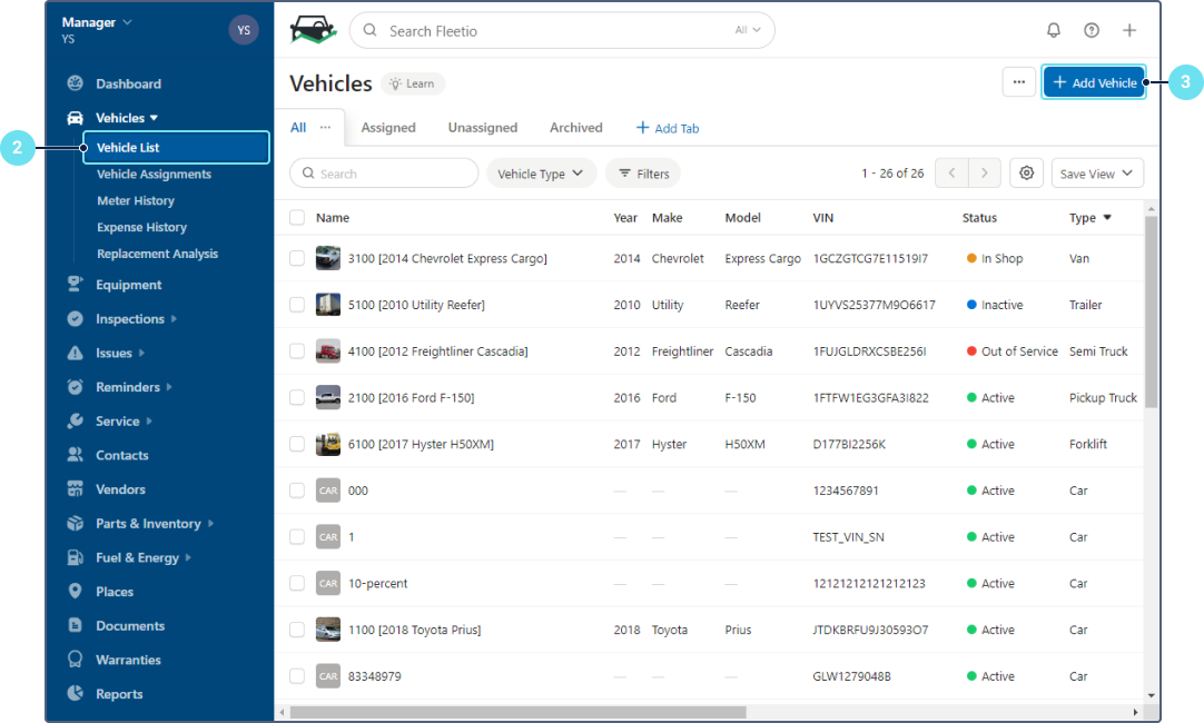

  1. Log in to your Fleetio account.
  2. Open the Vehicle list tab on the left side of the screen.
  3. Click Add vehicle.

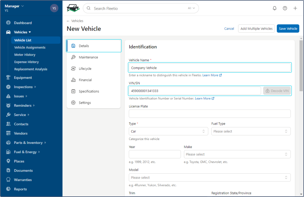

  4. On the Details tab, fill in the Vehicle name and VIN/SN fields.

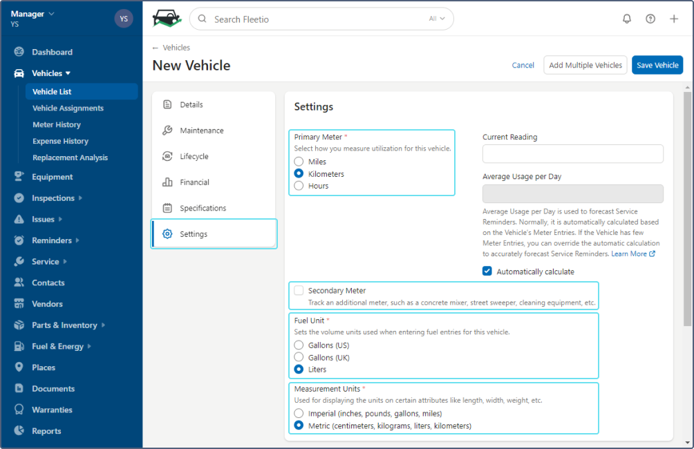

  5. On the Settings tab select measurement units for meters. To successfully send data, the measurement units of the primary and secondary meter in Fleetio must match the measurement units selected for unit counters in Wialon.
  6. If necessary, fill in the vehicle data on the other tabs and save the changes.

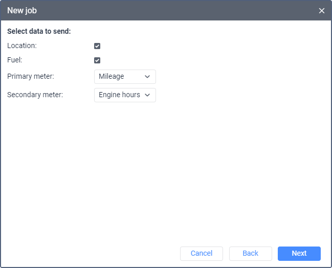

  2. Select the type of data you want to send to Fleetio.
  3. Select the units or group of units for which you want to create a job.

Data types to send to Fleetio
You can send information about the unit location, fuel, and data from the primary and secondary meters to the Fleetio system.

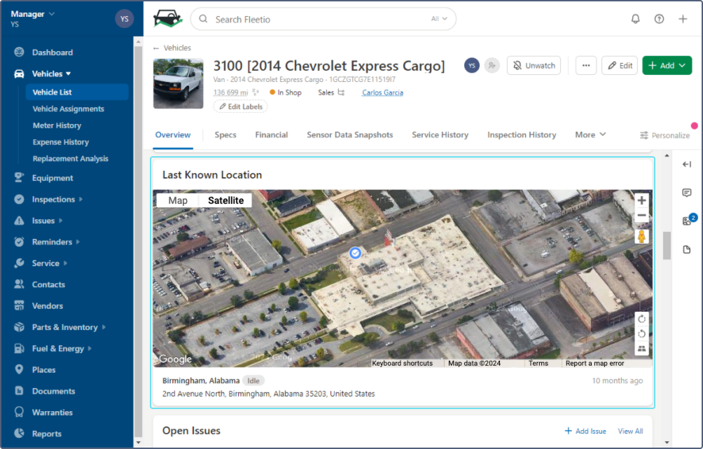

Location
When enabled, this option allows you to send information about the location of a unit. The coordinates from the last message that contains location data are sent to Fleetio.
When the job is triggered, the location is shown on the Overview tab of the vehicle.

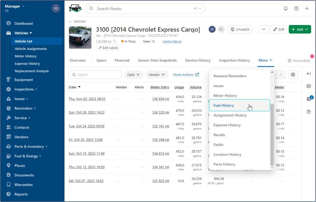

Fuel
For sending fuel level data, the selection of the primary meter below is mandatory.
If this option is enabled, the system transmits the fuel level from the last received message at the time the job is triggered. Fuel level is not transmitted if the last message doesn’t contain fuel data.
If the unit has several fuel level sensors, their values are summarized and transmitted to Fleetio.
After the job is triggered, fuel information is available on the More tab of of the vehicle. To see this information, select Fuel History from the drop-down list.
Primary meter
You can select a mileage or an engine hour meter as the primary meter to send data to Fleetio.
Selecting the Mileage option transmits the current value of the unit’s mileage counter.
When the Engine hours option is selected, the current value of the engine hours counter is transmitted. The data is taken from the General tab of the unit properties.
Read more about the meters in the Fleetio system in the official documentation.
Secondary meter
You can select the mileage or the engine hour meter as a secondary meter. You can select the same values for the primary and secondary meters.
When the job is triggered, the data of the primary and secondary meters are available on the More tab of the vehicle. To see them, select Meter History from the drop-down list.
