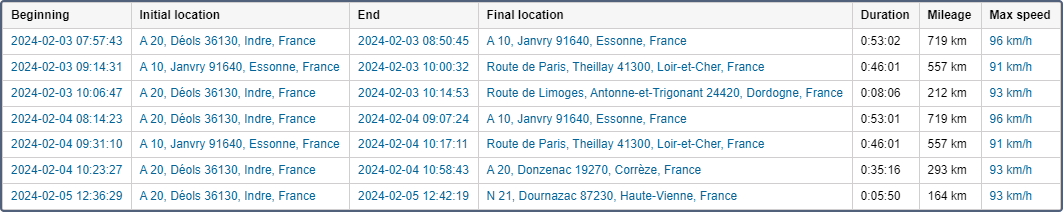

Trips
The Trips table shows the intervals of movement with the indication of time, location, and other parameters such as speed, mileage, fuel, and many others. The intervals of movement (trips) are detected according to the parameters set on the Trip detector tab and adjusted for each unit individually.
The Trips table can include the columns described below.

The tracks of the trips can be displayed on the map for the Trips table. To make use of this feature, in the report template, select the options connected with the rendering of tracks on the map.
Settings
You can apply the following settings to the Trips table:
