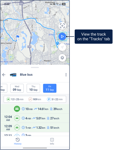

Unit track on the map
To show the full-day track covering all trips on the map, tap the summary row for the day.
To see the track for a specific trip, tap the trip row in the detailed data list.
To open the track on the Tracks tab for playback and viewing events, tap the icon . The app navigates to the Tracks tab with the time period preselected: the full day if the summary row is selected, or the trip period if a specific trip is selected.
