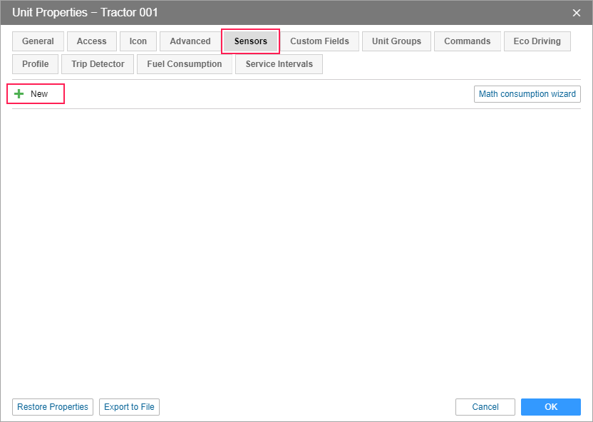

  1. On the Sensors tab of the unit properties in Wialon, click New.

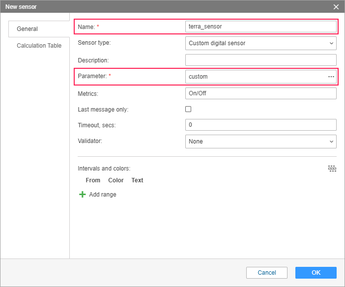

  2. Fill in the required fields: sensor name and parameter. Click ОК.

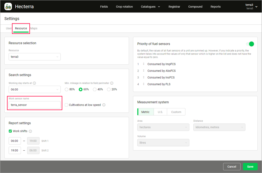

  4. Select Settings in the user menu in Hecterra. In the Work sensor name field on the Resource tab, specify the name of the sensor configured in Wialon. Click Save.
Now the system will identify as potential cultivations only those parts of the unit track, where the work sensor was on. Besides, the part of the track where the sensor was on will be displayed as dark blue on the map.
