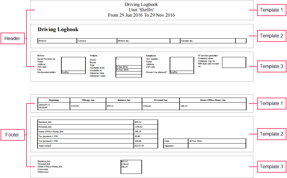

In the Print section, you can customize the layout of the report for printing. For the Header and Footer fields, you can select one of the three available templates that determine what type of information should be in the first and the last page of the report.
Moreover, you can enter the values for the Taxable mileage and Tax payment parameters in the corresponding fields of this section. The sum of a refund is calculated on the basis of the indicated parameters. To display the refund sum on the taxable mileage in the printed report, select Template 2 in the Footer field and activate the Show payment option.
