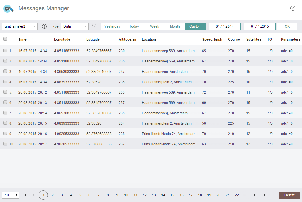

You can make a request in the top bar of the application. In the bar, you should indicate unit name, message type, filter (if necessary) and the time interval for which you want to receive messages. There are two types of intervals available: established (Yesterday, Today, Week, Month) and adjustable (Custom) for which you can indicate any dates. By using the Previous/Next arrows you can change the established interval for a day, week or month.
After indicating all the necessary parameters, the corresponding information in tabular form appears automatically in the central part of the interface. You can filter the table by time, speed and number of satellites. To do this, click on the corresponding parameter in the table header.

Depending on the selected message type, the table can include the following columns:
  • For data messages — time, longitude, latitude, altitude, location, speed, course, satellites, on/off, parameters.
  • For SMS — time, text, phone.
  • For commands — time, command name, its parameters, user, channel, execution time.
  • For events — time, type, events text, longitude, latitude, parameters.
